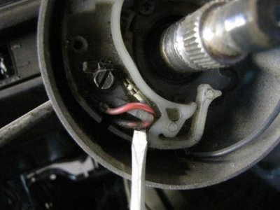

Please explain Switch. Are you referring to the plastic wish bone cancelling device with two wires that connect to existing wires in the column, or is there more to it that must be replaced? Without pulling the steering wheel I can't see the switch. I replaced the wishbone part to correct a broken piece that would not cancel the signal.
Did your brake light issue come about after you replaced that part? The switch is the entire plastic assembly in the column, Including the cancelling cam you changed. The two wires in the pic below are usually the culprit. They take a couple hair pin turns in the assembly and like to crack/break at those points. Either that or the contacts they interface with. Anyways, a guy would be hard pressed to find any new aftermarket/RMFG turn signal switches/cams that are worth a can of beans..They all suck! I'd at least revisit the wiring and operation of that piece you changed.
Take the cancel cam back off. Gently pry the the four spring wires a bit away from the cancel cam so they make better contact when you reinstall it. Try not to over tighten the screw when you reinstall it it tends to distort it. Thats what worked for me.

Wing: Thanks for your advice. Unfortunately I did not understand at the time, but finally figured it out exactly as you said, without buying new parts.
Loubo: Thanks for the advice. It was exactly as you said and I was able to fix the problem without buying new parts.
