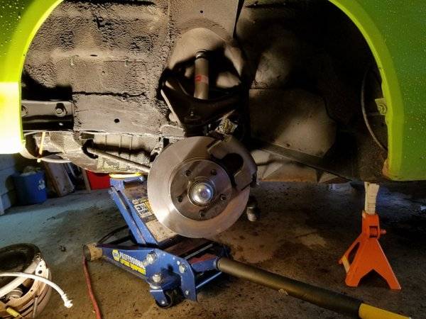

Just finished the Right Stuff front disk brake upgrade, has anyone used this on a B Body and found the front hoses are too short? Either way lock to lock it stretches the crap out of them, found this out when I took it for a drive, oopps, was so excited I forgot to look at them before.
Anyone got a correct part number and vendor if these are the only ones that they have?
Swap your spindle/caliper assemblies. I first installed mine so the calipers hung towards the rear, and had the same problem... they can go on either side. Switched sides so the calipers hang towards the front and all good ('68)
Tear everything apart again??? isn't there a mopar hose that's a inch longer? :BangHead::steering::BangHead::mad::icon_fU:
You may have to call right-stuff.. If you go searching, I do know the kits are based on a 73 dart but don't know any part number..in my case I opted to just switch sides..I think it took an extra 10 or 15 minutes. I wasn't in the mood to find and order new ones and wait around..
You have a front sway bar, so calipers are on correctly.
Contact Dr Diff for the correct brake hoses as his kit is similar to the right stuff.
I set mine up with rear mounted calipers due to my sway bar. This caused me to need longer brake hose as well. The ones I got were Raybestos BH36830 and 31. They are 16.75" long. These are the ones that require the banjo bolt running through the block at the caliper.
