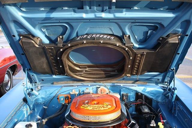

'69 hood with functional hood louvers aka "Air Grabber". The screens were red from the factory.
Here's the underside.

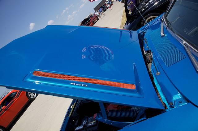

Here is the non functional "solid" version. They were black.
And here is the side facing '68's. They were all solid and non-functional.
Yep, Ranger is right. '69 hoods straight up in the air & they're all the same. No air-grabber got blocked off hood inserts & air grabber (same hood) got the vents, the fiberglass air box, cables, air cleaner, etc. You can turn any '69 Roadrunner/GTX hood into an air grabber. The '68 is at an angle and there is not an air grabber option.
