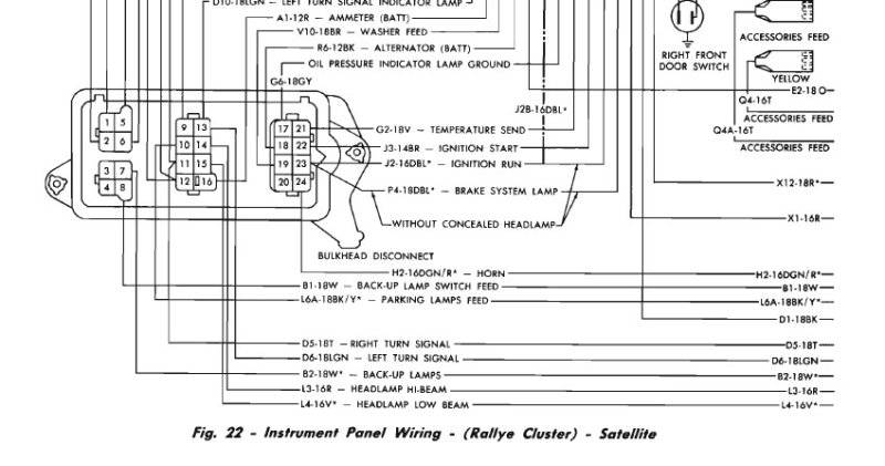

Kinda what I thought, any idea where that sucker comes out of the engine harness? That I have not replaced, so might be cut somewhere.
Green with a red tracer, in the dash harness, runs directly to the fuse box mounted horn relay. Bulkhead cavity #24 H2-16GN/R*
Okay, I'll give it a gander, does it run on top of the engine with the alternator wires, or should it be seperate along the firewall or frame? Thanks again buddy.
