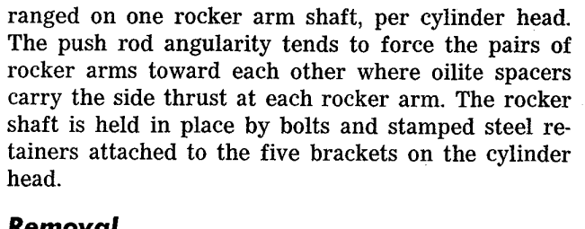

Should the shaft hold down brackets be touching the rocker arms? Some are and some aren’t on my set up.
I think you’re fine. I just checked a picture of my GTX’s rocker arms and they looked the same. I have roller rockers on my Charger though and the hold downs are right up against a thin shim on each side.
If they aren't touching I'd be trying to understand why they're not - are the pushrods rubbing the heads? If everything is free and clear only then would I not be concerned. There is also a lot of play in a stock setup so that just might be the position they were in when the engine was shut down.
If that's a big block there should be a spacer between each pair of rocker arms. If they're in place, you're good..
The arms do have a right and left offset where the pushrod dent is shaped and installed so the pushrods are close together.
The tips of the rockers should be centered over the valve stem pretty closely.
I would honestly like to see you install them wrong !!
And FWIW, I've never seen a stock set with "oilite" spacers - all I've ever seen were just steel.
The rocker on the left (in the first picture) looks like it's a little bit too far away from the rocker shaft hold down. The rocker on the right looks okay.
Thanks for the replies, the pic Don Frelier posted shows them touching the rocker arms. They do have the spacers between each rocker arm, some of the rocker arm tip wear patterns are a little off, not centered. Going to buy a new set from 440 source, have my heads at the machine shop after I found 2 bent pushrods and 3 pushrods not even on the rocker arms, they were just laying there.
That's not a picture I believe it is a drawing from 1966.

That's usually from the rockers not being correctly oriented...though that may not be the cause in your case.
Check out the picture Don F posted above....the pushrod cups in BB rockers are slightly offset to one side or the other. Each pair of rockers gets installed so the cups are closer together/toward each other.
It could just be the angle of the pictures.....but look closely and make sure someone didn't stick small-block rockers in there:eek:
