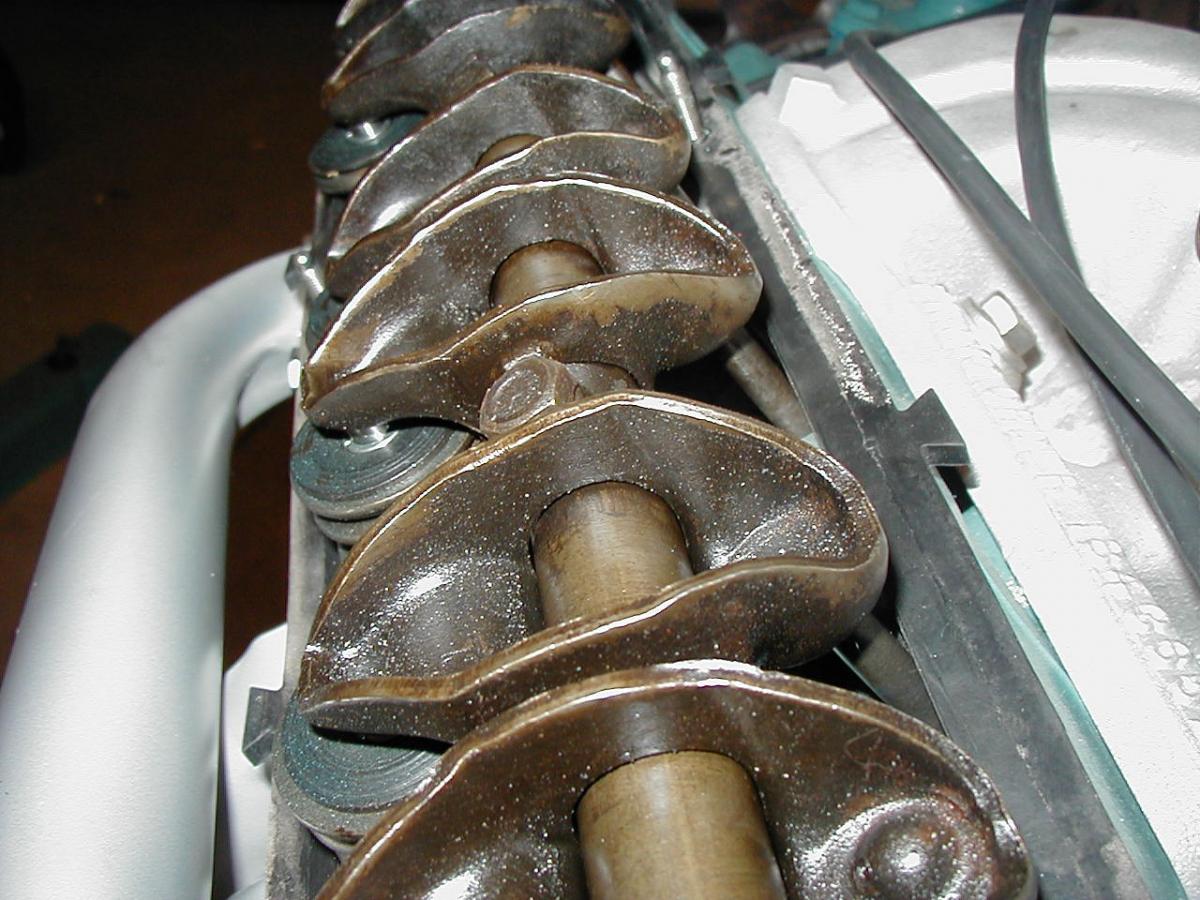

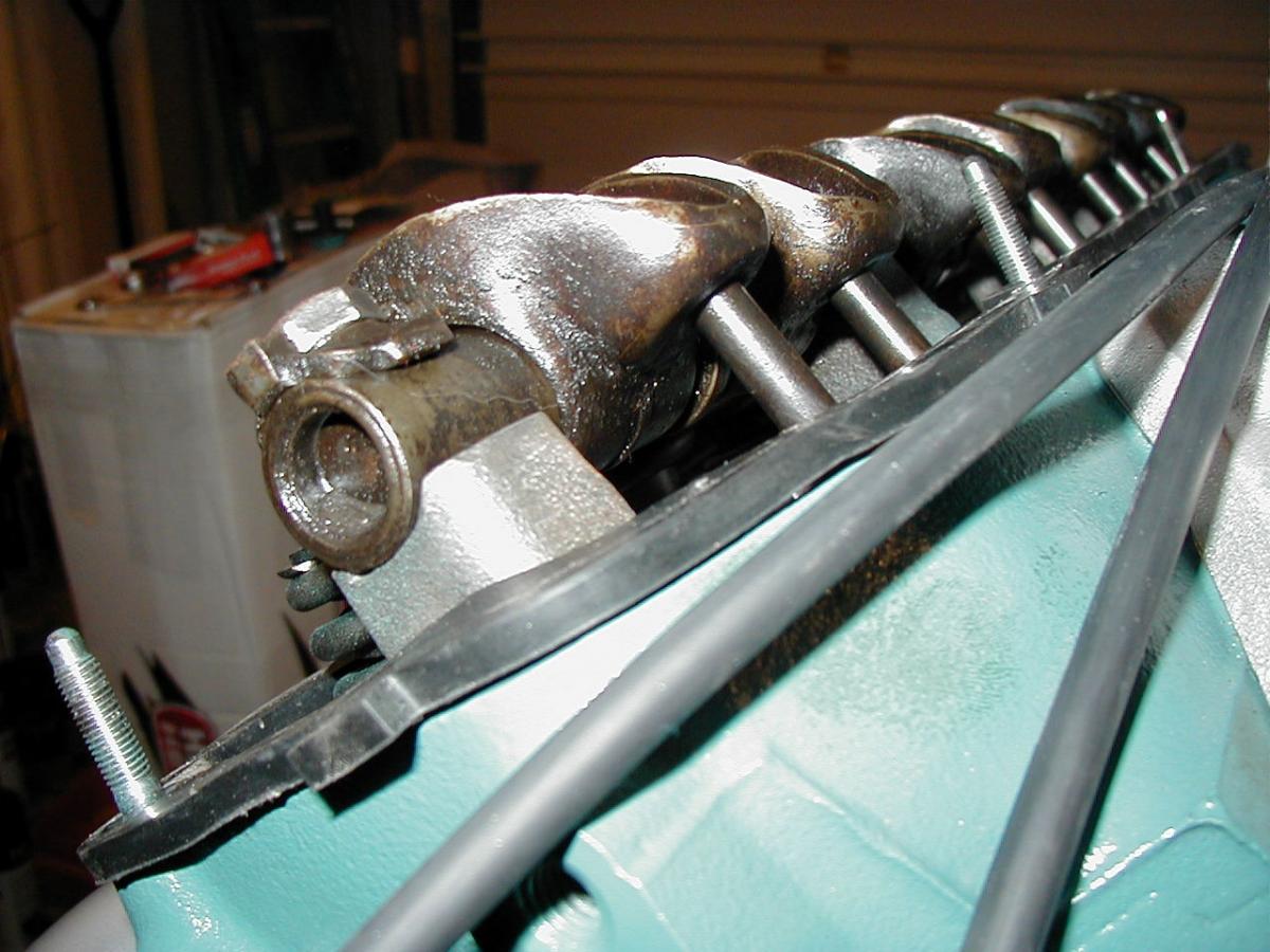

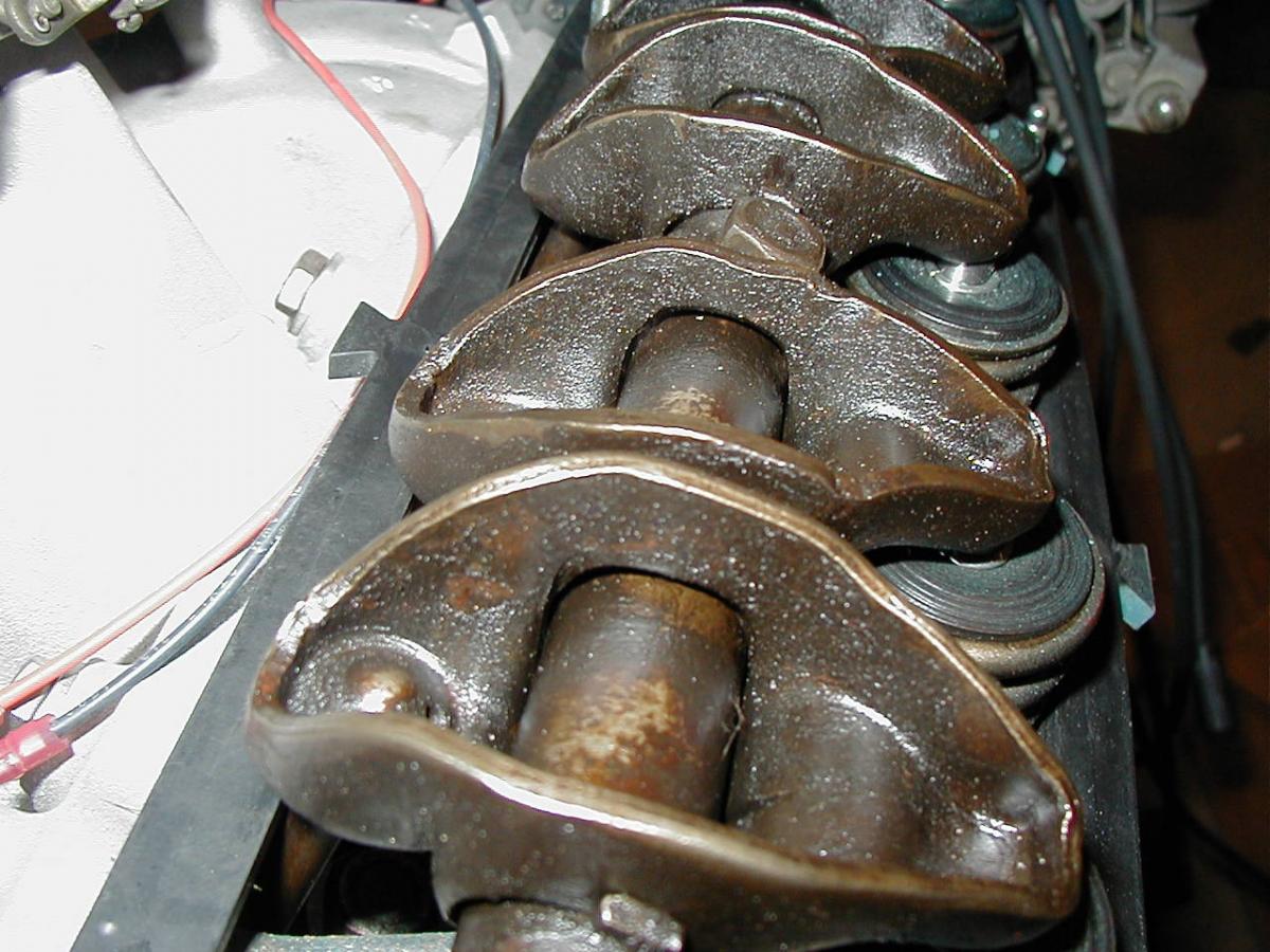

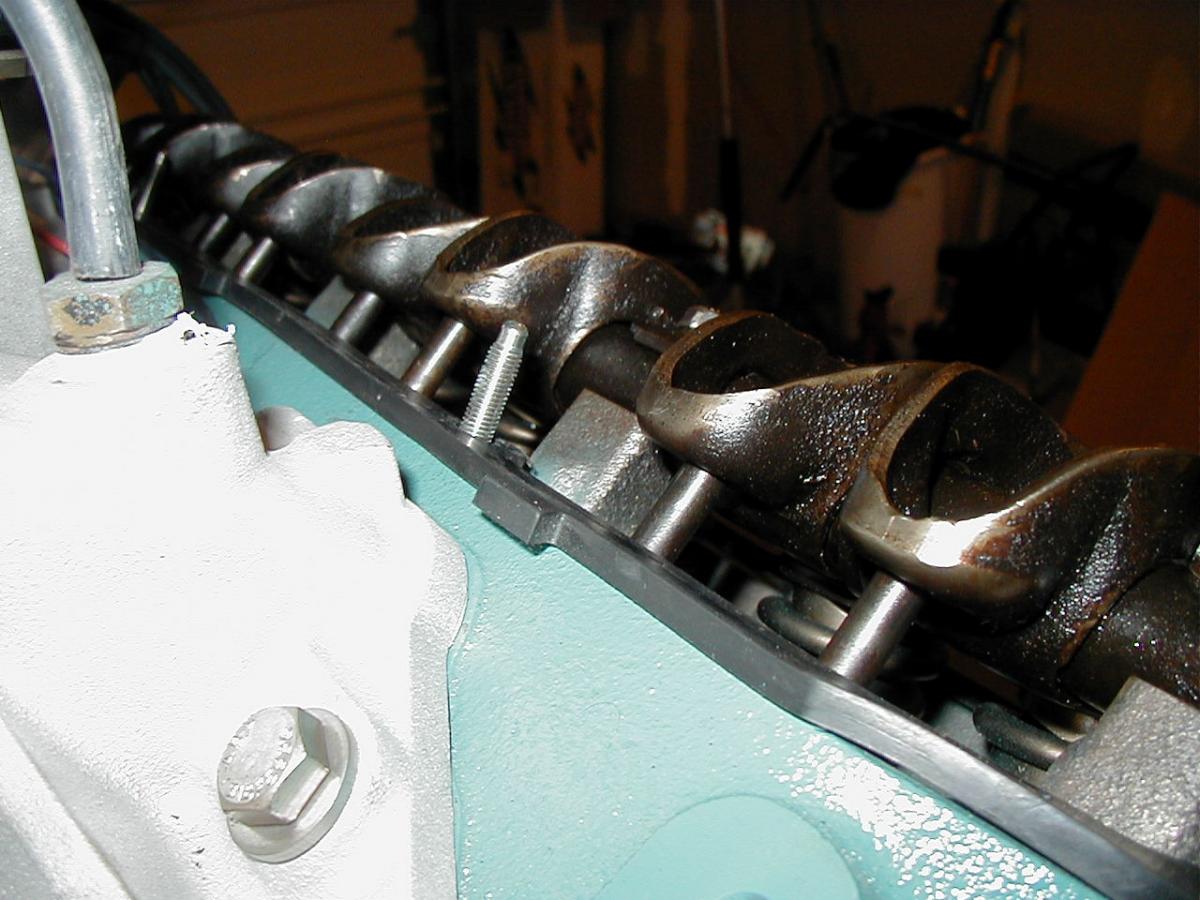

I was just looking at the rocker arms on my 383, one side has equal clearance but the other side looks like it ovaled out and is showing over an 1/8"...ya think that may have been the tick I was hearing frm that side before I tore the engine down?????

Pics? Stock rockers tend to have a lot of clearance on the top side.....what's important is if the bottom, which rides on the shaft, is good.
First two photos are the worn ones and the second two are the ones that appear equal. They look a lot worse in person and yes, they are dirty.:violent-smiley-100: The worn ones are almost able to slide over the retaining keepers on the shafts.

Like Cranky said, the top doesn't matter because it normally doesn't touch anything - it's just stamping irregularity. However, if you have a few showing a lot of gap compared to the others then it's possible the business end (area in contact with the shaft) is very worn. If you are able to slide it off the valve easily when the lobe is at the base circle that may be another indicator that something is badly worn. Personally I would dump those and get a set of iron adjustables from Isky or Crane. Hard to beat those in the bang for the buck dept.
From what I can see, the heads look relatively nice but the rockers look pretty old....is that the case? Push rods and rockers are a wear item and if you just rebuilt the engine or did a top end job to it, the rockers and push rods probably need replacing too and especially so if they have a lot of miles on them.
And looks like you're running some nice retainers and heavier than stock springs too. The springs probably helped do the already worn rockers and shafts in.
