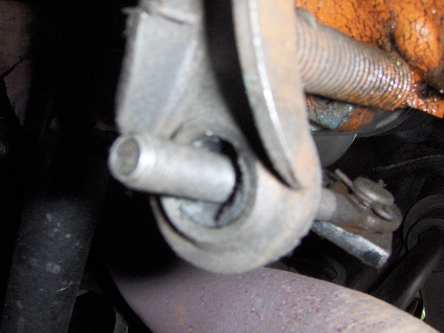

I was under the car today and noticed that on the rear-facing side of the clutch fork there is no nut on the threaded portion. It is double nutted on the front side. Should there be a nut or locknut on the back as well?

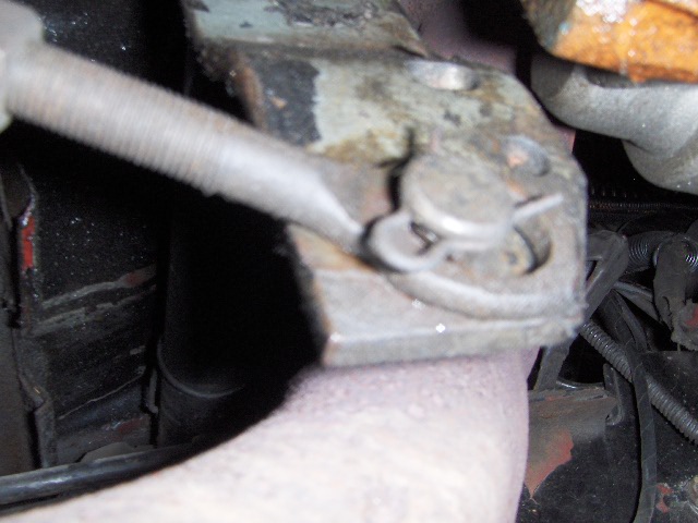

Also, on that same rod, on the front end of it..where it meets the pedal mechanism there is a lot of slop between the pin and the hole in the rod....looks there should be a bushing there. Is anybody familiar with this...is there bushing that is missing here?
Hopefully the pics help
Nope, no nut on the back. There should just be a single lock style nut for the adjustment on there. Front of the rod should be a "D" shaped hole. The clip you have there is wrong, but, like the double nut set up, if it works, don't sweat it.

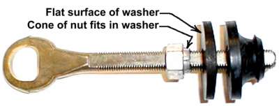

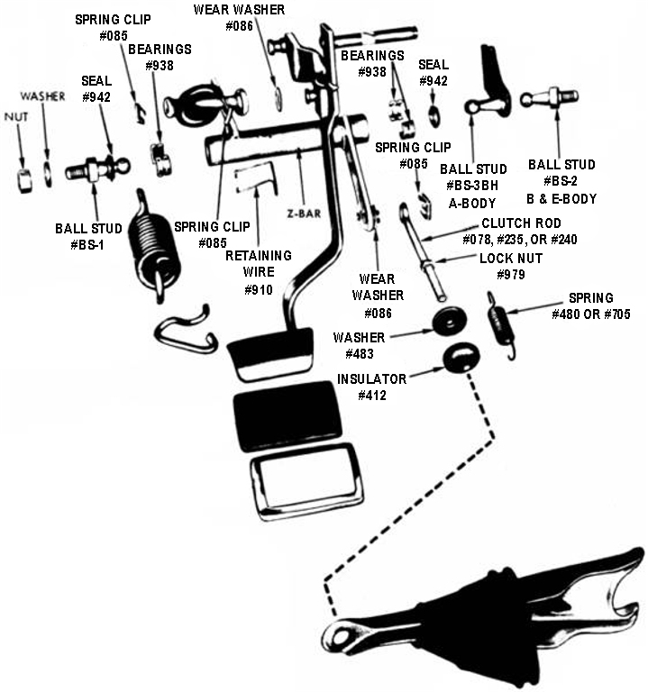

There should definately be a rubber bushing in the fork that the rod goes through
Yep, there is a bushing in the fork. But the "D" shaped opening at the end of the adjusting rod kinda threw me off because it looked odd.
heres two photo's might be helpful
