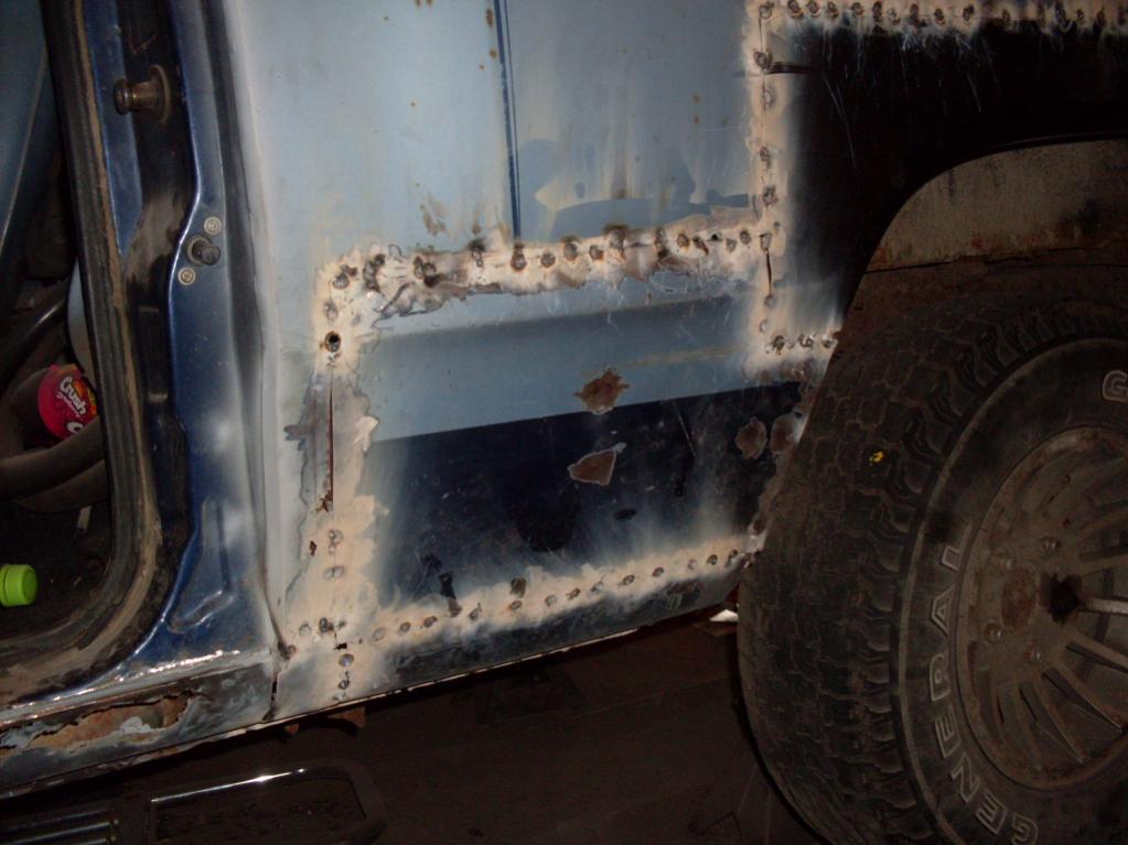

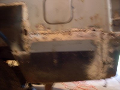

i got one patch on today and will work on the back one when i get back.I found out the sides of the p/u bed have a different curve underneath so i will have to match them as close as possible.Will put some pics up b4 i put the body filler on.

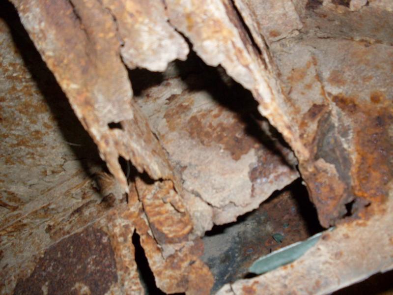

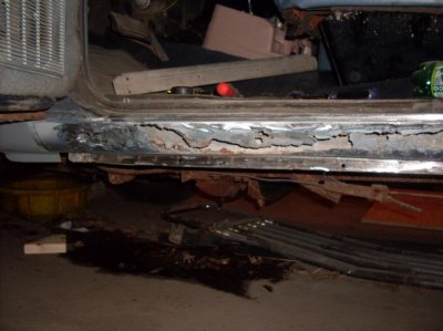

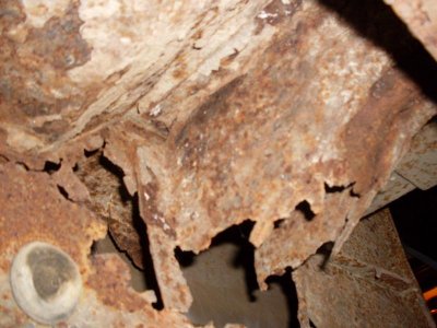

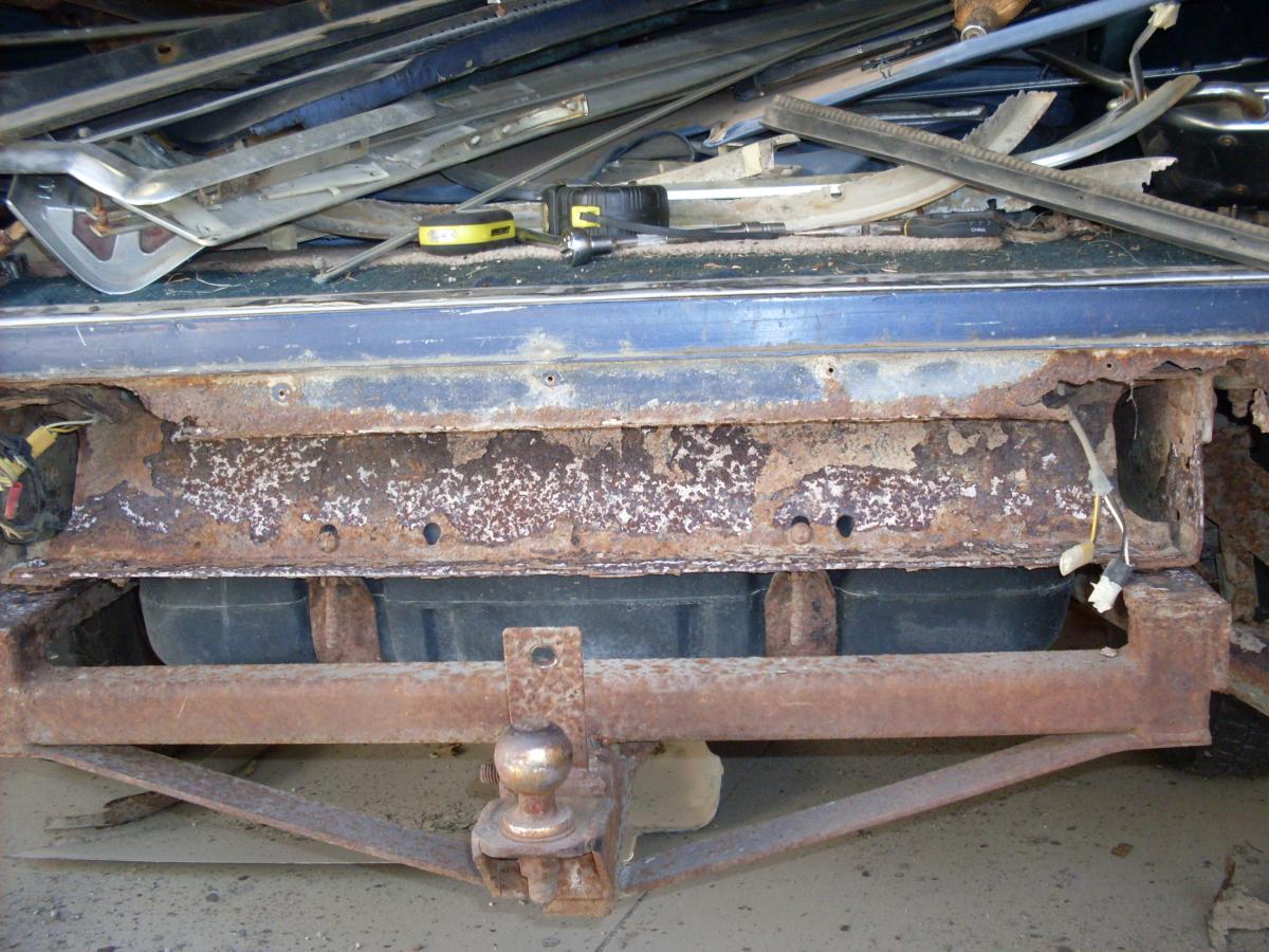

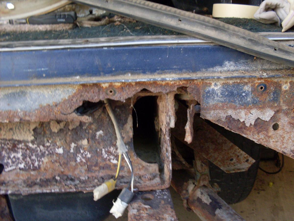

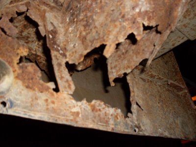

did some work yesterday on the trk,took the rear bumper off and found good ole' cancer.blew the cross support and had to wait a couple minutes for the dust to clear out.

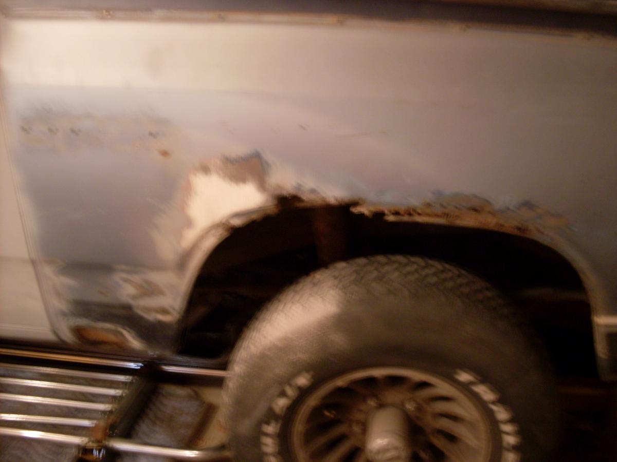

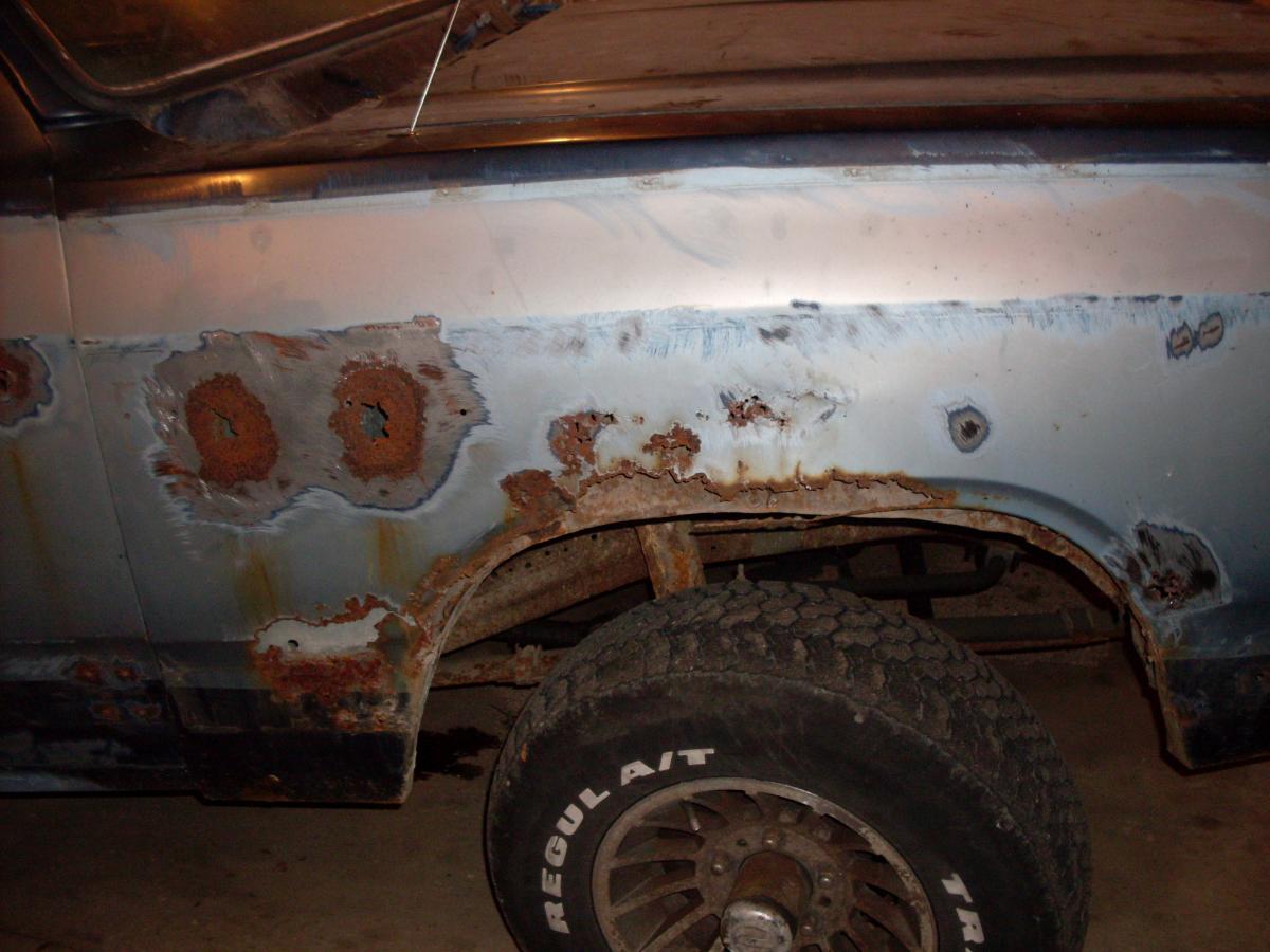

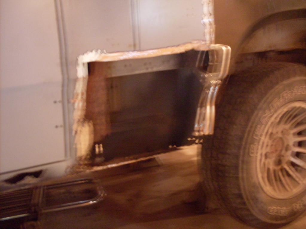

i have been doing some work on it.

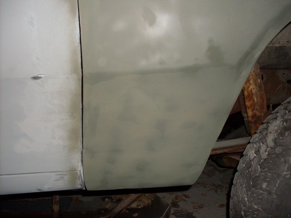

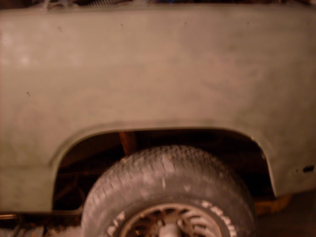

thanks will, i hope to get the rest of the panels welded and in primer today.
i've always liked these trucks. most more pics if you have time.

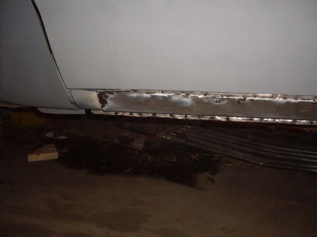

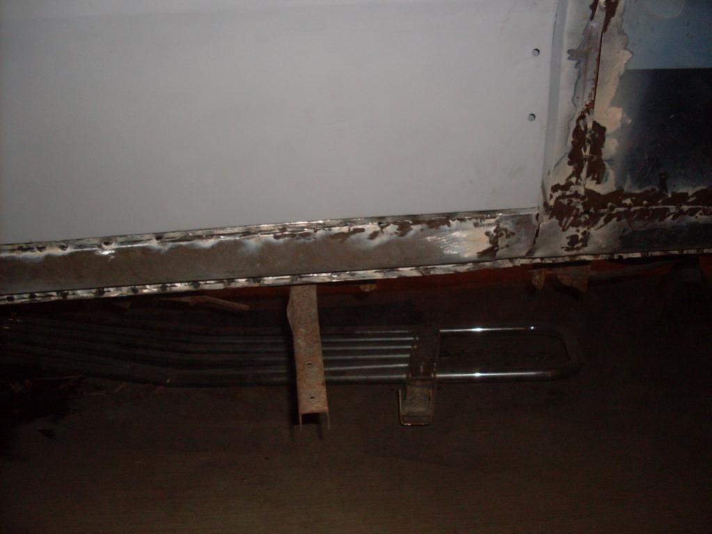

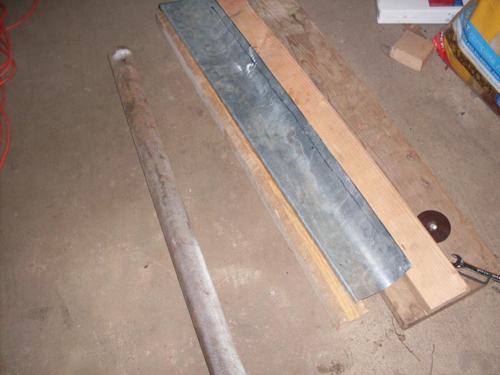

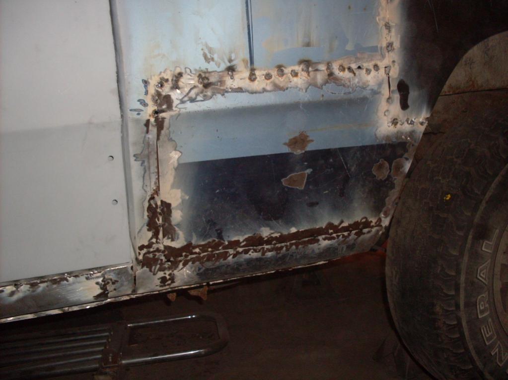

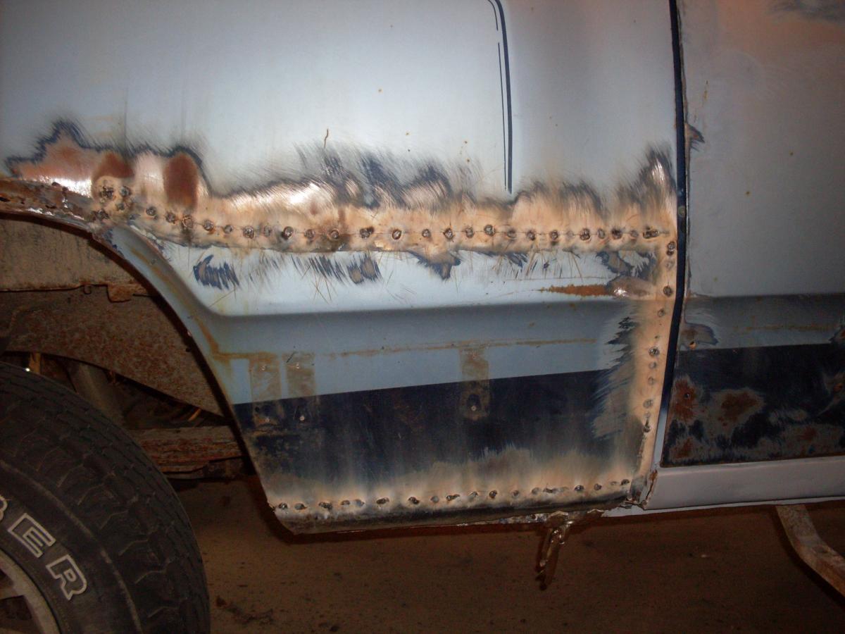

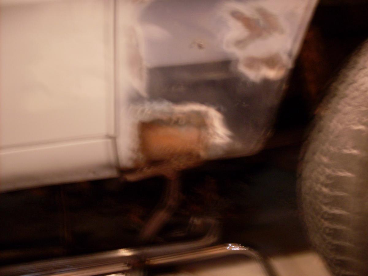

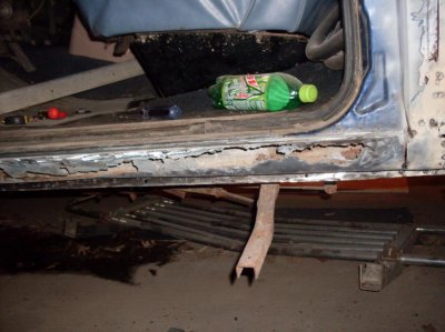

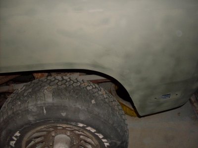

well i did get some more work done on the ram today.Not in primer like planned but getting closer.the first picture show the rocker panel that i had to form from sheet metal.After i cut the right size and made my lower lip,i then put the metal on top of two boards and took the steel pipe seen in photo and gently dropped it on the metal to give me my lower contour.I know that's probably caveman method but it work really well and matched up pretty good.Didn't get all the spot welds ground down,but will see if i get time tomorrow.

It must have gotten cancer from smoking (tires). Hahaha. Goot job on the metalwork, keep the good work going!!
thanks,i do what i can with what i have to work with.

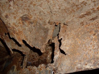

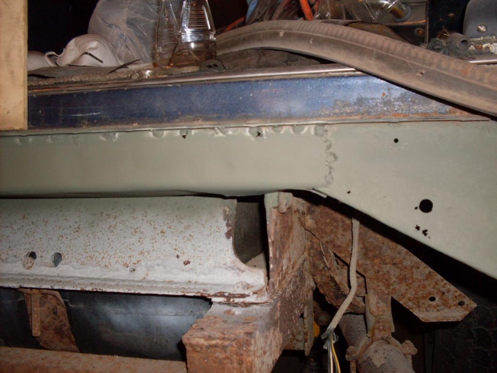

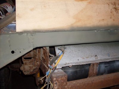

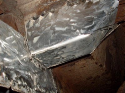

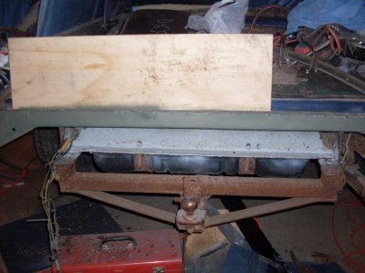

did some work on the under side off the ramcharger a couple days ago.had to fix the crossmember on this and had to make my own,it's not the best job but hope it will keep to weather out of it for a while longer.i still have to primer it and then spray undercoat.
