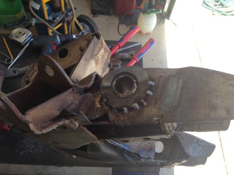

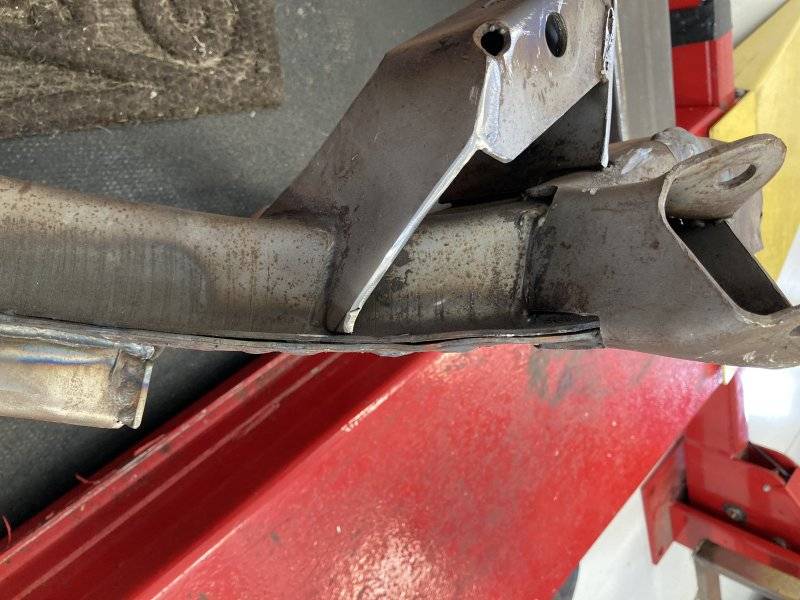

Here is a picture of the 70 unit I'm using. Compare that to the 65. Double shear is what you see in the pics. Both ends of the bolt are secured. On your 65 unit, the top of the bolt can move around, only the bottom is secured by the mount.
