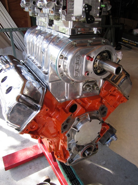

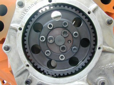

I use the comp cams nylon button with the Milodon gear drive:blob1:
What about the reinforced Milodon covers with the 0.90 (or maybe its 0.090) metal plate inside the cover?
Not a stock cover,they will flex enough to cause problems.You need a reinforced cover like the one I posted.He makes them for other resellers like Mancini & Hughs.
Thanks for the tip on needing the reinforced cover. I guess spending $350 on the proper cover is small insurance for a $5,000+- "built" motor.
