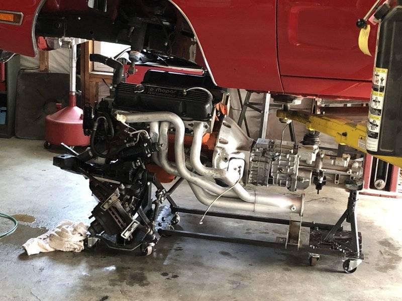

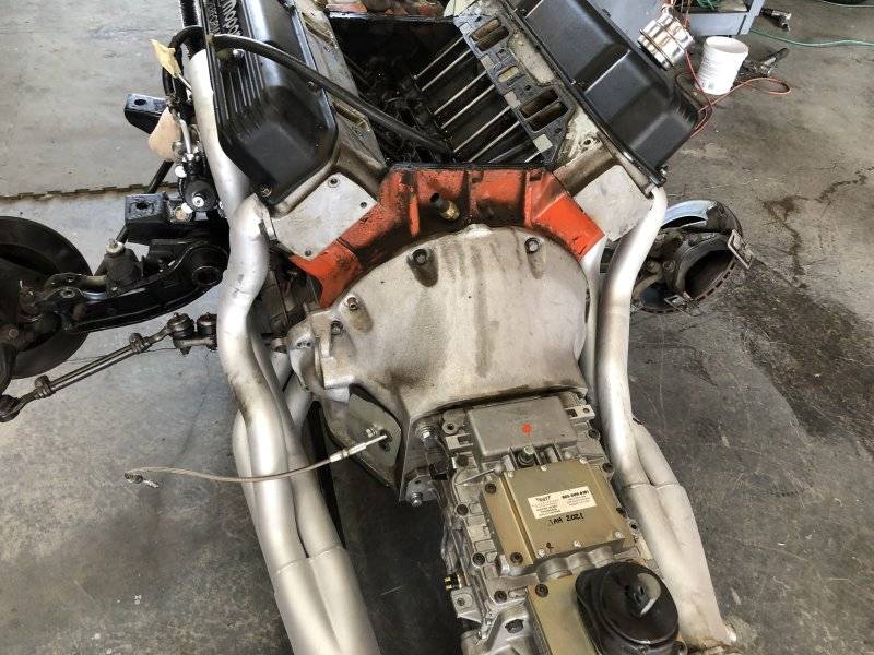

I had the engine out last year at this time....
I went through it.....new dished pistons to lower compression a bit, refresh the heads, some suspension and steering mods since it all was apart.
I pondered a switch to a roller cam at the time but kiboshed it. Cost was one factor. Another was that I had a good used Lunati solid flat tappet cam that I'd used before.
I don't necessarily regret using it but it clearly isn't an ideal cam for the combination.

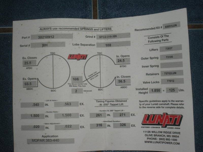

Here is the cam card....
I have 1.6 ratio rocker arms so the lift is even higher than shown on the card.

Lately, I've kicked around the idea of actually making the leap to a roller cam IF one could be spec'd to improve power, vacuum and overall drivability. With the little that I know about roller cams, I have a feeling that it is all possible.
It seems to me that this Lunati is probably too much for this engine. I think this because the '528 was by comparison a LOT smaller yet not that much slower than it is now.
I just wonder if the Lunati specs are better suited for a larger engine with better heads and more compression.
The engine isn't soggy or sluggish but the low idle vacuum annoys me. It certainly isn't as snappy under 3000 rpms like it was with the '528.
My curiosity about how a properly chosen roller cam may deliver more vacuum, more power and maybe even better mileage creeps into my head sometimes.
This engine is a .040 440 block, a 4.15" crank and measures out at 495 cubes. 9.8 to 1 compression with 2" headers, 3" exhaust, 5 speed manual with 3.55 axle gears. The car is just shy of 4000 lbs plus me.
Does anyone have a car set up like this one with a roller cam you like? Care to share the details on your setup?

I ran a MP '528 solid that had that old school .028/.032 lash. The Lunati in there now is .020/.022 so I am used to hearing some clackity clack. A fairly silent old V8 seems weird in theory but I could get used to that.

On specs alone, that looks milder than the ‘528 aside from the lift. I would need help understanding how it might make more power.
My hope is to surpass the ‘528 in power but not be too rowdy for cruising.
You cannot compare solid cam and hydraulic cam 0.050 and lift specs directly to each other because of the lash. Obviously you need to subtract lash from the lift. The MP 528 actual valve lift will be close 0.50" if adjusted to the recommended .028" lash.
For 0.050" duration, the lifter on the solid cam is really at 0.030", if the lash is adjusted to 0.030" (assuming a 1.5 rocker ratio (0.030" (lash) divided by 1.5 = 0.020" subtracted from 0.050")). A general rule of thumb is you subtract 8-10 degrees of duration off of the solid cam when comparing to a hydraulic. In the case of the MP 528 cam, it will likely be about 10 degrees because the lash setting is so large.

Roller cams lobes look more aggressives, but the valve action might not be more aggressive. They look different because how and where the roller wheel contacts the lobe verses a flat tappet. The flat tappet cam exerts more leverage on the lifter at low lifts per degree of rotation than a roller. So for identical specs, the roller cam will look way more aggressive.....but its not.
You can compare them directly, but it is helpful to also have the duration at 0.200" as well as 0.020" and 0.050" and total lift, presuming they are both solid or both hydraulic.
