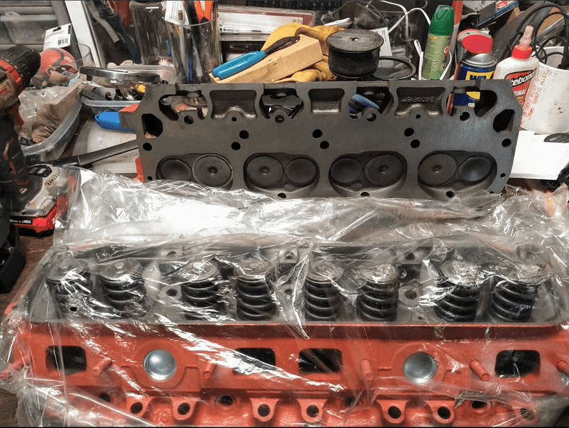

Do you have a picture of the heads?

Don't know how much this picture will help because of the plastic wrap. And also I just remembered that the actual castings are 516's but they have had larger valves installed and were ported so they are at the same spec as 915 heads.

Those springs and retainers do not look stock. Maybe you can have one checked for open and closed pressure
