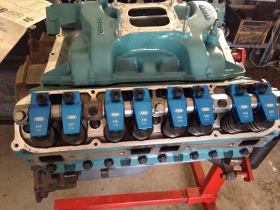

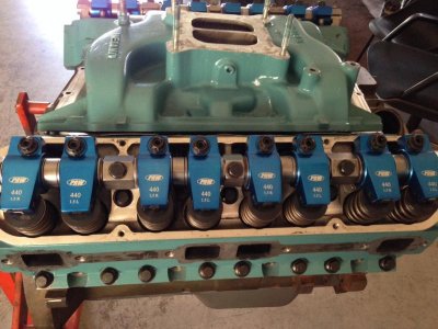

My current 440 build....
Yup, 440 Source Aluminum heads and valve train for the 67 GTX

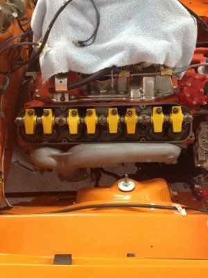

FWIW, I've been using the 440Source roller rockers for the past few years, 92 dragstrip runs and counting with no problems. Maybe it helps that my valve spring pressures are mild.
