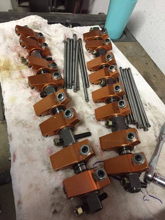

Broke the 470 in, and I think I have s problem. My rockers are Harland Sharp roller rockers and it looks as though I don't have enough oil hitting the valve springs, also not much oil at the bottom of the head.
I did prime before fire up and I got oil out of both sides, pressure was good. At idle it doesn't look like there is enough oil, and at 2400 there's a bit more but imo, still not enough.
Anybody got a suggestion as to what to look at?

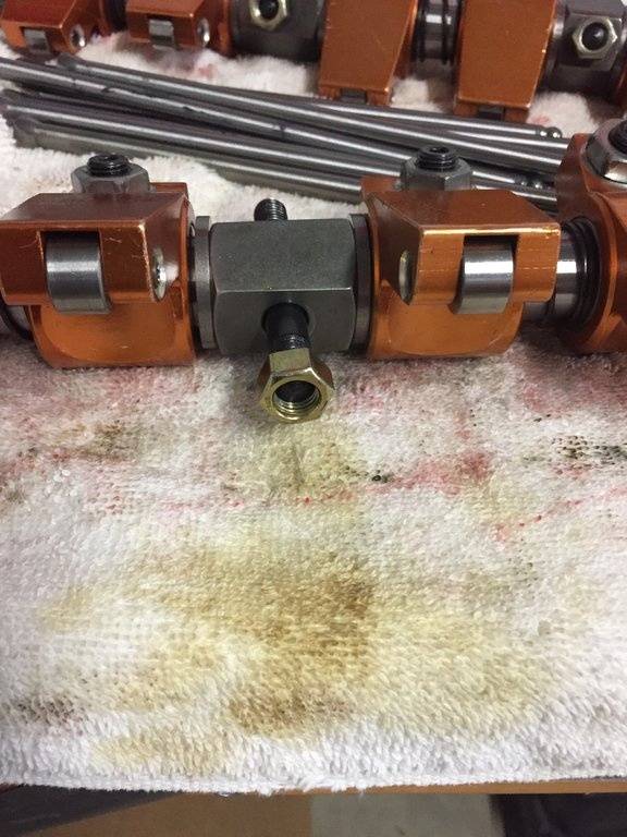

The HS rockers I got came with shafts that not good in my book so I bought some shafts from 440SOURCE. They have the small oiling holes on top and bottom of the shaft so I figured that would work better with the needle bearing rollers.
When I primed the engine I got A LOT of oil out of both sides, enough that it took me 20 minutes to clean up, all rockers received oil.
Engine was broke in, everything going according to plan. It's now that I see not much oil pooling in the bottom of the head at hot idle with 40+ of pressure at 800rpm. It still has break in oil 5w30.
It does have a new Melling HV pump.
My thinking is the spacers are a not allowing the oil to come out easily and my worry is not the roller itself, but rather the springs.
What was the deal with the HS shafts? Wondering if there's any dif, between them, and the ones your using.
And, did the cam go into the bearings, not tight enough, to turn any of the bearings?
My bad, down and out. As mentioned, i think the hs shafts have the holes inline with thr bolt holes. If the 440 shafts have smaller bolt holes, open up the lower bolt hole where the oil comes up. My cam is not grooved for oiling, and so far no problem. Only 0.620 lift hydraulic roller cam.
Did you use shims under the rocker shafts? The ones I have are bolt size and can restrict flow into the shafts if not opened up.
those HS shafts are induction hardened. you need a hard shaft to be compatible with those hard needle bearings. i think the idea of the rocker fulcrum oil hole down and out is only relevant to non-rollerized rockers. i can't imagine 440 source stuff being as good as HS. i'd call HS.
I ditched the HS rockers for my Isky ductile iron rockers. No dhims were used under the shafts. Turns out the HS rockers were just to tight on the shaft, not allowing enough oil to escape the rockers. Isky is doing just the opposite, I can see oil leaving the sides of the rockers and there is plenty of oil getting on everything. Still have 50 psi (thereabouts) at hot idle and flowing oil.

The "down & out" is correct for "stock" or ductile or Crane aluminum rockers. The full rollers I've seen use the double drilled "in line" orientation. If not enough oil getting out to oil springs, I would guess to tight clearance between rockers & shaft supports. Just my uninformed opinion.
