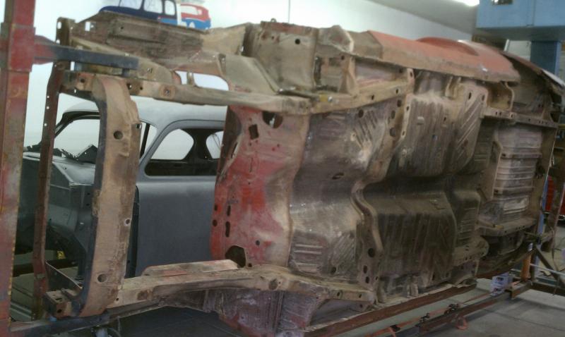

Here is my 73!

Here is my 73!
thank you , i like the spacers in the front frame rails good idea . how is it mounted on the back frame ? i guess they dont get mounted to the bumper bracket holes ??? or did you take another option ?

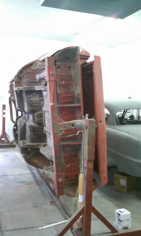

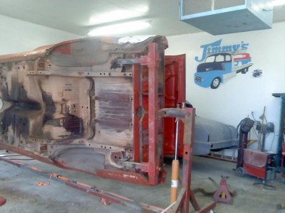

I believe the back is mounted to the rear leaf spring mounting position. I think bumper bracket holes may be too weak to support the weight.
Here is a better picture of the rear.
thanks that pic is alot better .
yep i dont know , im waiting to talk again with the owner of AS to see how they mounted their 74 rr to the bomper mount holes . the spring mount does make sence i guess but it looks like there is a pivot ponit the way it is mounted . ??????
