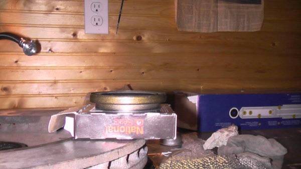

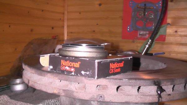

The first pic is how i tap it in or the second pic.Thanks.
1st pic I do believe, rubber part seals on bigger o.d. just inboard of where bearing sits on the knuckle.
The angled edge of the rubber seal itself, goes 'inward'. Can't see it in your pics.

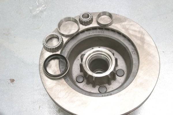

Hard to find a good picture. Just like this seal is laying on the rotor. Use a large socket or pipe that has the same diameter as the outer part of the seal. Don't tap on the inner part. Or go to your local parts store that rents the seal installation tool kit.
First pic. The steel lip is merely a dust shield
