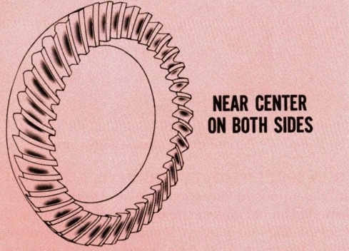

The pattern does look a little deep, I've never set one that deep, but you need to remember that under load the pattern will tend to move up and out along the tooth so it could be OK. You need to move both adjusters to get both the right backlash and preload. Looking from the rear the left adjuster would have to be a little tighter and the right adjuster slightly looser, assuming the preload is currently correct. The correct way is back of the right adjuster, tighten the left and then tighten the right for preload, then recheck the backlash and pattern. Don't be surprised if a couple of tries are needed to get both where you want. As for the depth of the pattern it doesn't look ideal. See attached for what to aim for.
