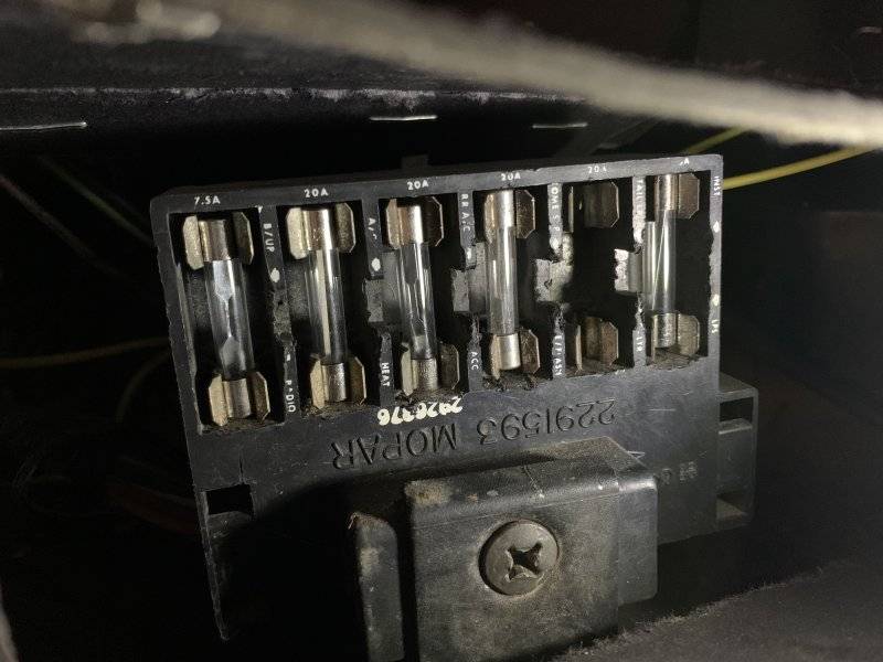

Hi all. I was just about to set off for an evening cruise last night and decided to do a quick light check and good thing I did. Headlights were on but tail and park lamps were not. Brake and signal lights all worked too. I checked my fuse box and sure enough the 20amp tail lamp fuse was cooked. I changed it and hit the light switch and it just burned out immediately. I’m no electrical wiz but checked the battery side of fuse block and saw about 25V, load side was not showing anything for resistance (not sure if I’m reading the meter correctly). Where should I be looking here and what should I be looking for? I know my lights were working perfectly fine just a few days ago and this all of a sudden happened.
Oh and can someone tell me what the correct current amount is for my far right fuse (instrument )? It’s worn off and I can’t make it out.

Tailight fuse should be either a 10A or 15A... 1st check for a shorted bulb/socket, or U may have a shorted, frayed wire where it passes through a grommet in the trunk...

25V showed up on the multi-meter. And maybe my eyes deceive me but is that not “20A” above the slot for “TAIL LMPS” in my photo (the one with the missing fuse)?
