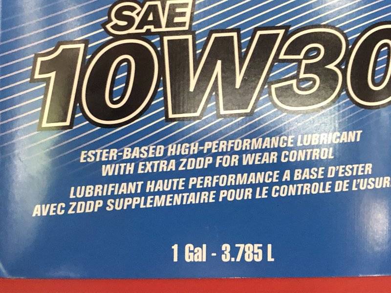

In 2022, I drove to and from Van Nuys CA for the annual Spring Fling car show. It was around 900 miles total and the car ran great the whole time. A couple weeks later, the engine started to develop a miss. I got gas and drove some more but then it started to detonate, the valvetrain noise got louder and got more sluggish. I lashed the valves but the damage was done.
I wiped out the camshaft.
For years, I ran Valvoline VR 1 and a bottle of Comp Cams supplement but had switched to a synthetic about a year before the trip. The synthetic claimed to have "extra ZDDP"...
I blame this oil for the cam failure.
I pulled the intake to get a look at the cam and lifters and noticed the worn lobes. I ended up pulling the engine and trans for a rebuild.
I hope this isn't the case for you.
