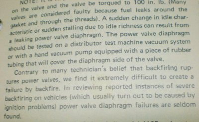

This is something you and most others need to read from Holley Tech literature before jumping to conclusions about power valve !!
