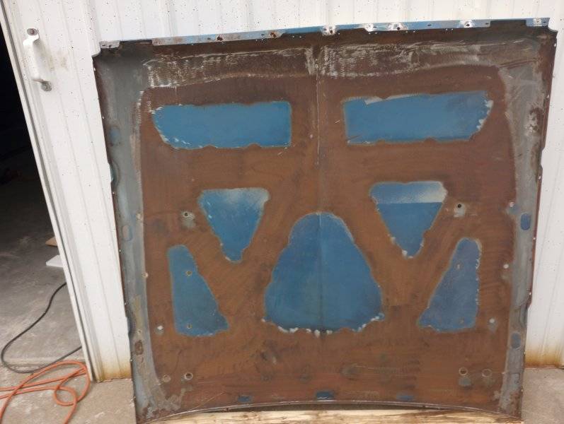

you could pry the seam apart lust a little; and hang a bag of molasses/water on the door for a couple of weeks
Molasses took that off? hang a bag on it? Wonder how far it would reach without pulling the inner panel?
