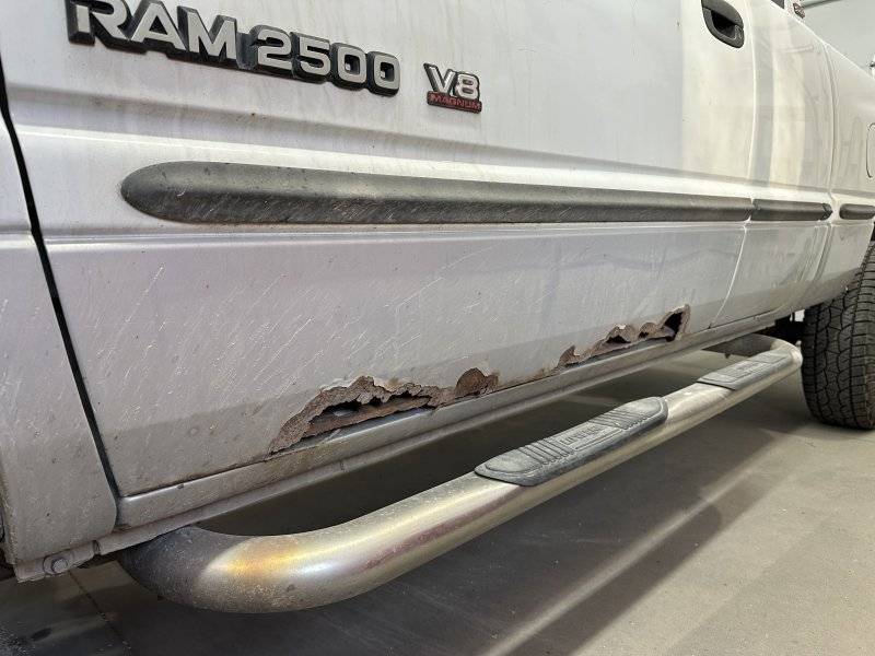

I blew this off for years on my old Ram until it got to this point. The passenger side was worse. Dry Colorado I thought. Stupid me. Lots of work to fix. Nip it in the butt now Rob.

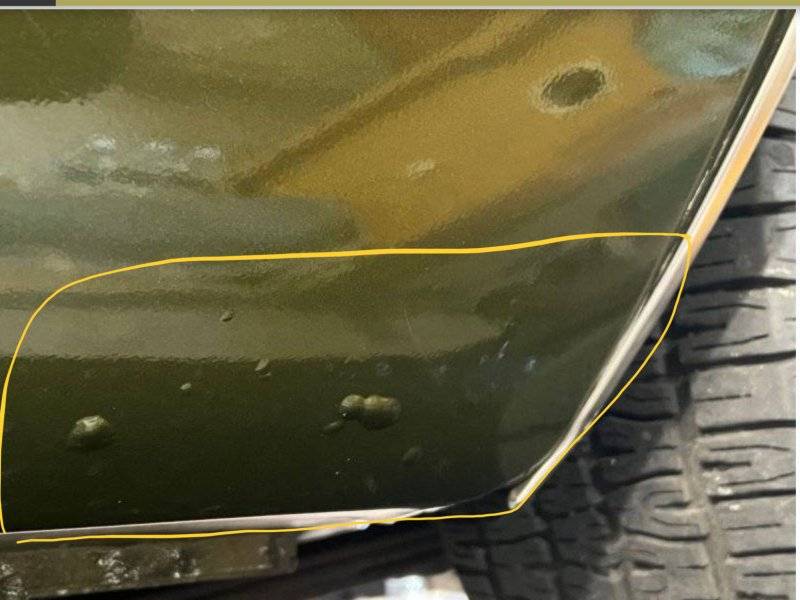

This is on the drivers side quarter panel on front of the tire. So it is just sheet metal, not the rocker that we see rust bubbling.
That is where mine is. I suspect it is from a blocked drain and yes, the galvanized rocker panel is under there. Hopefully it doesn't extend into the rocker itself.
Rockers are thick and galvanized. I've seen them pitted but still quite strong. The sheetmetal over the rockers gets rust damaged and eaten up much easier.
Well, I can tell you, since I started doing bodywork in the mid 70's, almost always I'd been surprised by the amount of rust/corrosion discovered after addressing the area affected. Paint is a good hider. I've pushed my hand through an entire area that rotted from inside, which only appeared as a few paint bubbles on the outside. I've air-chiseled into areas LOADED with bondo on the inside which didn't even show any paint defect on the outside. I've encountered quarter panels that were replaced by brazing the new quarter panel over the original panel in the sail area, leaving the original panel UNDER the new one in that sail area. I could go on. Could it be just a minimal repair, sure. For what it's worth, just offering a few snippets of what I've seen, and rust was never less than what I anticipated.
Thick rockers? Galvanized? Yeah.....Well, like a positive cancer remission declaration from the Dr, that sounds great but I'd still be nervous until I saw the evidence for myself.
