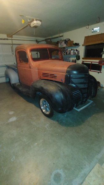

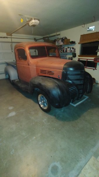

Sprayed my cab and hood
after sandblast with PPG
DP50.
Many years of transport
and exposed to humid and
dry environments before a
primer. This stuff has held
up extremely well. No rust,
