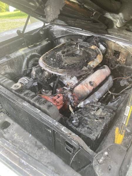

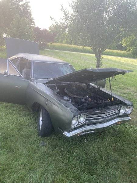

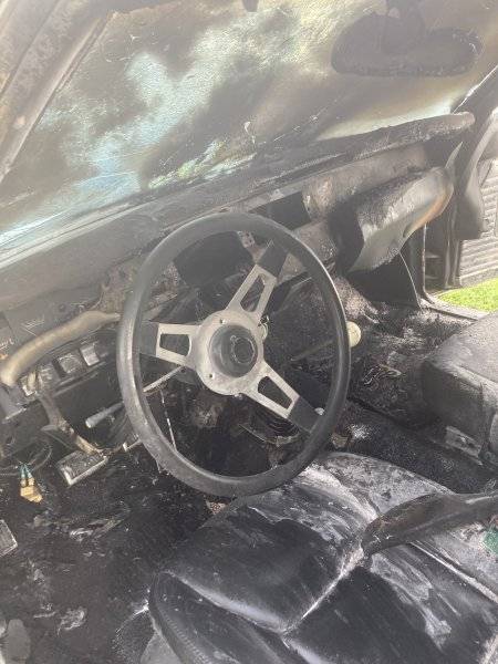

Well today was alignment day for the roadrunner. After getting all new ball joint, tie rods, control arms and bushings for the roadrunner I took it out for a front end alignment to a very trusted place that have aligned many cars for my family. I got it done and it drove the best it’s ever drove everything was good and drive home was just fine. I parked it in the garage and walked away and about an hour later my sister smelled smoke and she opened the door to the garage and sure enough smoke was everywhere and so she ran and got me and I saw fire from underneath the car. My dad and brother came out and got the car In neutral and shoved it out into the driveway and hosed it down. I’m still in shock. Before anyone asks me, no I don’t know what caused the fire. I’m pretty sure it’s electrical because we hosed down what was left of the wiring harness and it was hissing really loud. It’s still the original wiring. Not sure what I’m going to do except call the insurance company and have them assess the damage, they’re more than likely going to total it. It’s really not all that bad. If I where to rebuild it I would need a new interior, wiring, check brake and fuel lines, check all the rubber and I’m probably going to have to pull the motor and check it out and do all of the other little odds and ends. Any other things I should look for or inspect or do before the inspection for the insurance company?

I agree, the car can be repaired. I would definitely try to buy it back from the insurance company. Glad to hear no one was hurt and no other property loss happened. Usually when I see one where the fire starts in the dash nine times out of ten it's the amp gauge that causes the fire. I had it happen to my 78 Little Red Express truck. Fortunately I was right there when it happened and I disconnected the battery immediately. When I pulled out the insulation behind the amp gauge, it was on fire in my hand!

This is really sad to see, Paul. To me, it looks like it started under the dash, and progressed from there. My friend almost had the same thing happen to his '62 Dart Maxie clone. He had just purchased the car, and I was helping him with clearing up some mechanical issues and detailing it. We had made new fuel lines, and replumbed them to look more original. We had removed the alternator to build lines at the fuel pump, and reinstalled it. It was getting late in the evening, and I suggested leaving it, and trying to start it the next day, out in the driveway. The next day, we pushed his car out of the garage, to start in the driveway, in case we had some fuel leaks. With my friend cranking the engine over, I was watching for a fuel leak at the pump. I noticed a wisp of smoke at the alternator wire. I looked up to tell my friend to stop cranking, and noticed fire and smoke at the firewall connector. We quickly got the battery disconnected, but the damage was done.

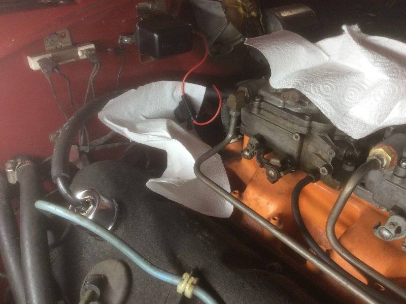

Put a 7.5 amp fuse on the spade side of VR, a member recommended for safety.
