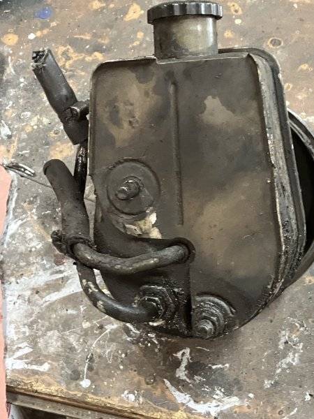

I have heard of them but never personally seen one. Do they actually exist? My Google-Fu must be weak because I can’t find one. I’m adding hydro-boost to the GTX and I’d rather not run a TEE in the return if it can be avoided…
I got one from a wrecked 1990s Chevy flatbed with a 454.

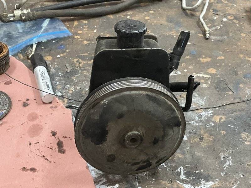

There are several different versions with two returns. There are the "canned ham" shaped ones, rounder ones with integral reservoir, and round ones for remote reservoir...
Caravans used them I had a new one at some point but I think that I may have sold it at some point.

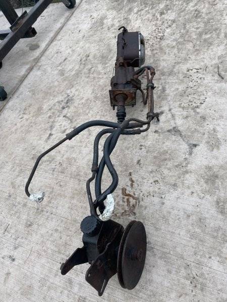

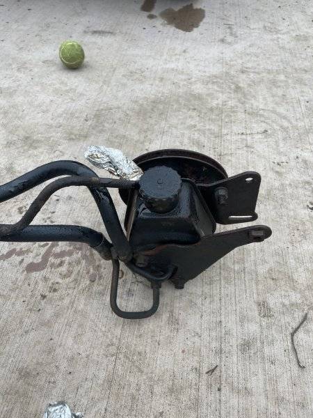

I kept this off a motorhome I parted (for a GV overdrive). Was bolted to a 440. Not sure if it is a saginaw because I know diddly squat about power steering pumps.
