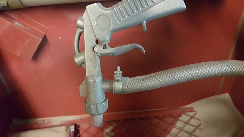

The key is to find one flexible enough for use but doesn’t kink. Also, I had to grind out metal on the inside of my hf gun to greatly increase flow (poor casting). Made a huge difference.

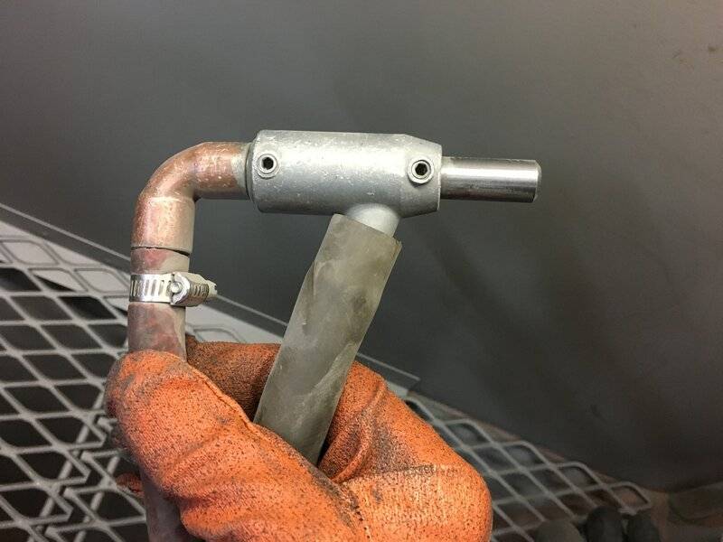

This is my "home-made" gun - made from one of those cheapies. Its now smaller and lighter - operated by foot pedal. The key to good performance is a carbide tip.
