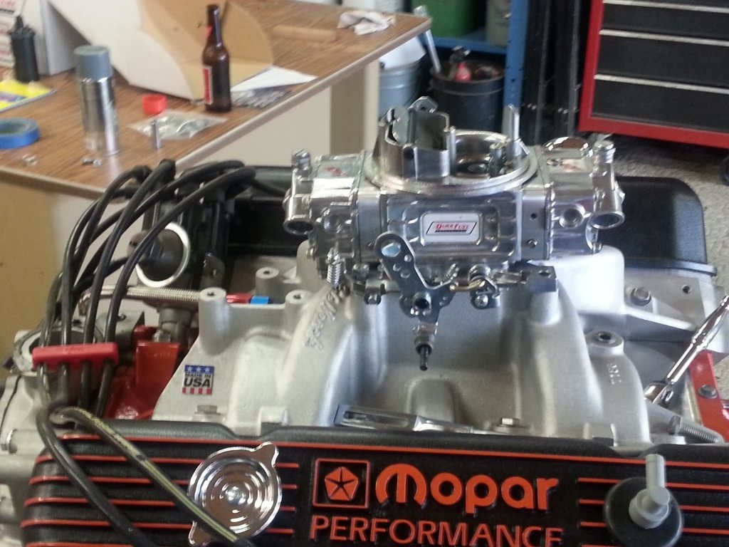

I have the Quick Fuel carb and RPM intake
