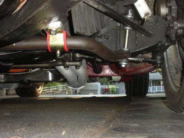

I know in 70 the sway bar was changed but are the sway bar mounts in the same location on both LCA's for 70? The 69 and older B LCA's were more inboard, right? Anyone have pics of the differences?

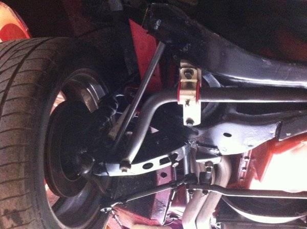

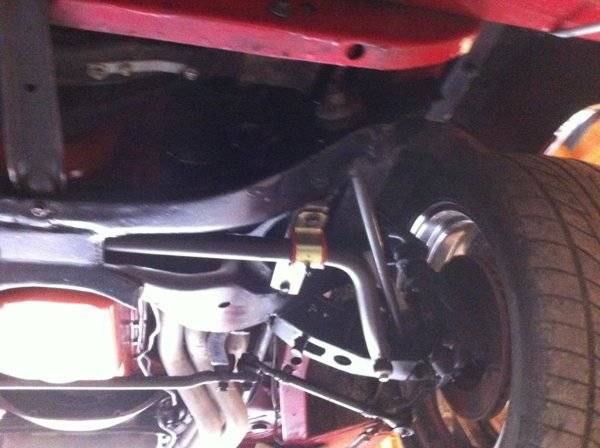

70-72 B body LCAs are the same as the 70-74 E body cars.
The sway bar brackets are almost midway between the ball joint and LCA pin on them. The 69 and earlier used a further out mount that also sat lower in the arm.
Example below: My 70 Charger.

That's what I have.....
That's what I do not have!
Thanks to you both. I was pretty sure I had 70 and later LCA's since I parted mostly E body cars during the 70's and later and very few earlier B's....and kaint remember any of the B cars having front sway bars.....
