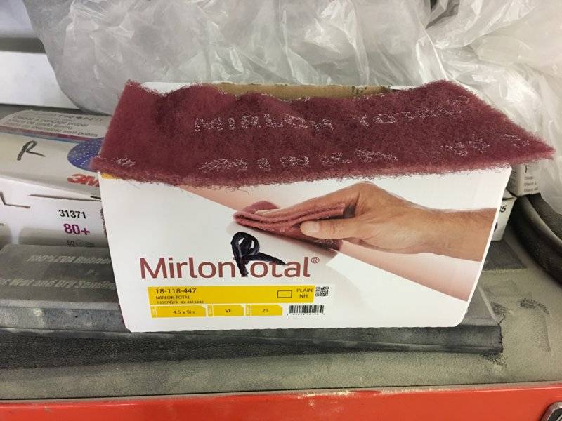

Since the next coat is going to be primer, block with 220 and red scuff pad in tight areas. If you’re using the old school stiff as a brick red scuff pads, get the scuff pads as in the picture. A little more coin then the old stuff but once you use this stuff, you will never ever go back to the stiff scuff pads.
