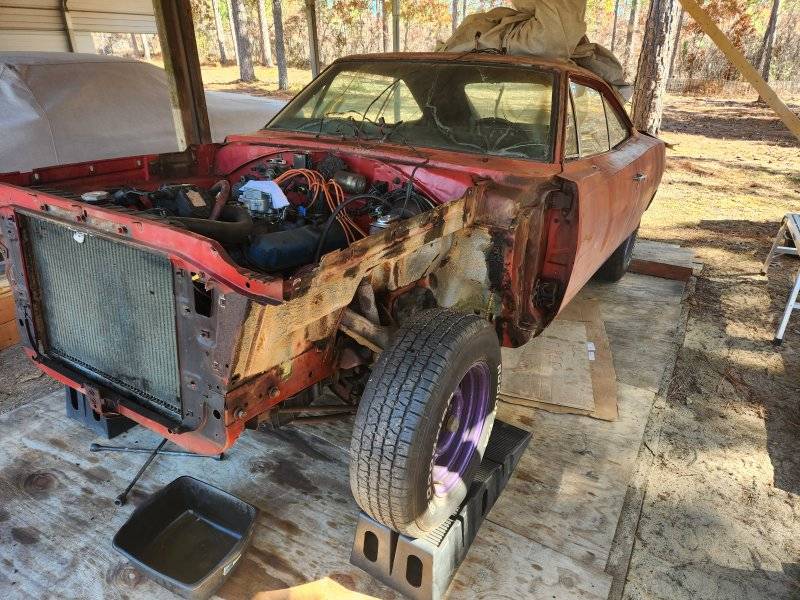

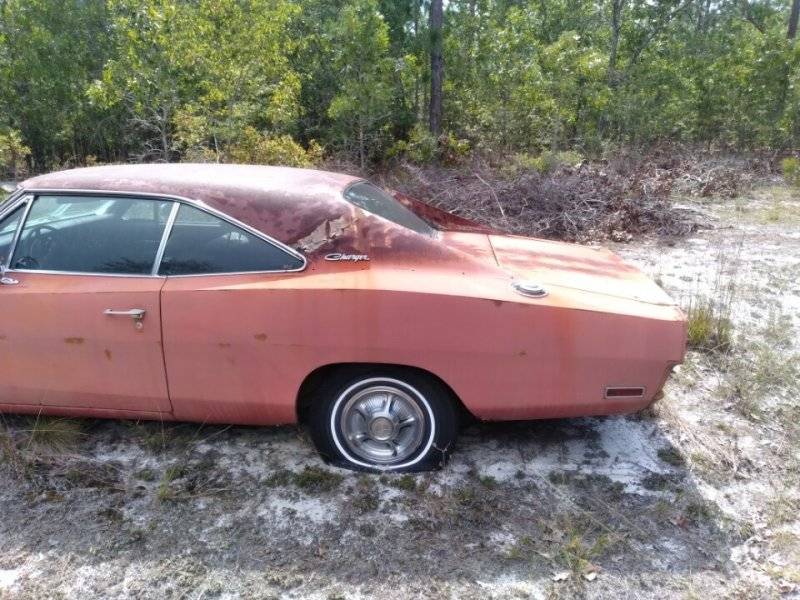

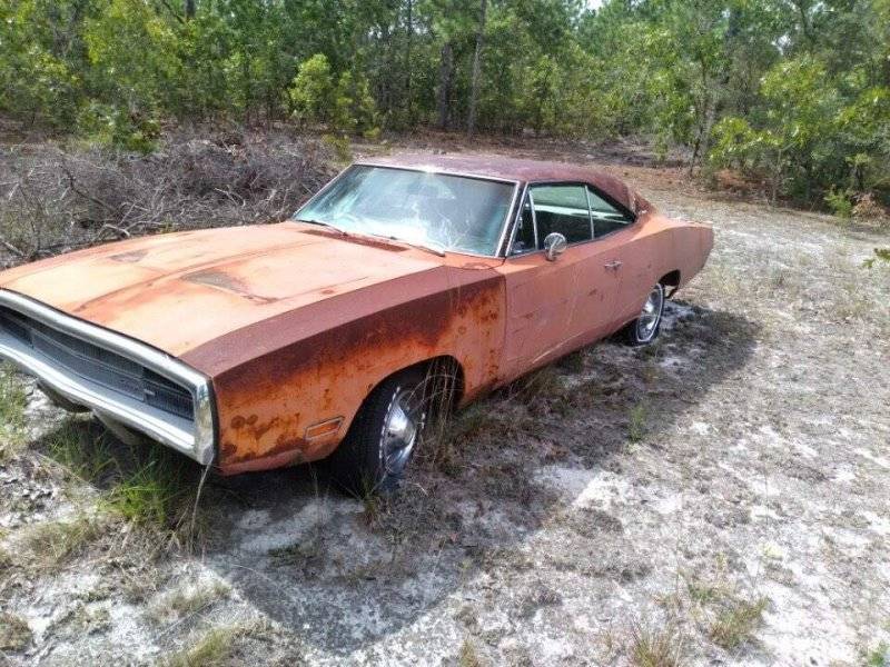

So Im still waiting for the metal work to get done. So Im going to prime the car while waiting. The charger did have a repaint I think on it so dont know if I can spray over it. Sat outside for over 10 years so paint is dull. Im using Omni epoxy so can I spray over the paint . I know I have to scuff old paint and sand any rust off. Wipe down . I just want to get the car sealed. All the work is being done outside,no garage. Charger is striped down no fenders,hood,trunk lid or chrome pics are for just a reference.

It is always best to strip down to bare metal because you don`t know what is hiding underneath, just sanding will not completely remove rust, you need to sandblast or chemically treat. If you are just sealing it to prevent more rust untill you do strip it back to bare metal that is fine - just scuff it up and wipe it down with cleaner and shoot.

Metal prep the rusty areas. I agree i wouldn't trust that old paint.
Take it off.

You may get away with simply block sanding an area with NO obvious rust down to factory primer. But if there IS rust you can see, going to bare metal and treating the metal is your best option to stop the rust from progressing below (later added) paint.
Unless the car has been out in a dry arid location like New Mexico, if it's been sitting out in the rain for 10 years or more, there is likely rust all over hidden and visible, and you may need to go to bare metal and treat prior to primer.
A die/angle grinder fitted with a sturdy wire brush (rated for the high RPM) can make quick work removing the existing paint. I would estimate the bulk of the paint can be removed in just one day using such a tool.
