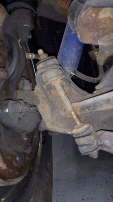

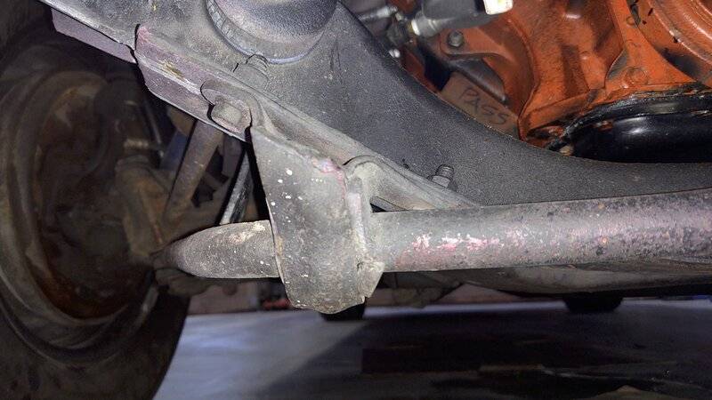

Just when I thought I was done fooling with Fred for a while, I noticed this:
See the shiny mark on the LCA? Yeah, it appears the sway bar has been contacting it some.
(Yes, I know everything looks nasty and dirty down there; I had planned on a thorough scrubbing of it all once my brake project was done - and it is!).

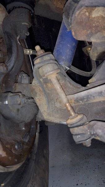

The whole dang sway bar has shifted to the drivers' side, in fact....

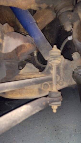

Have a look at the drivers' side:
While the passenger side link is laid way over, the drivers' side is pretty much plumb vertical.
The whole dang bar has obviously moved over, so I guess it's time to replace the bushings,
links, etc.
