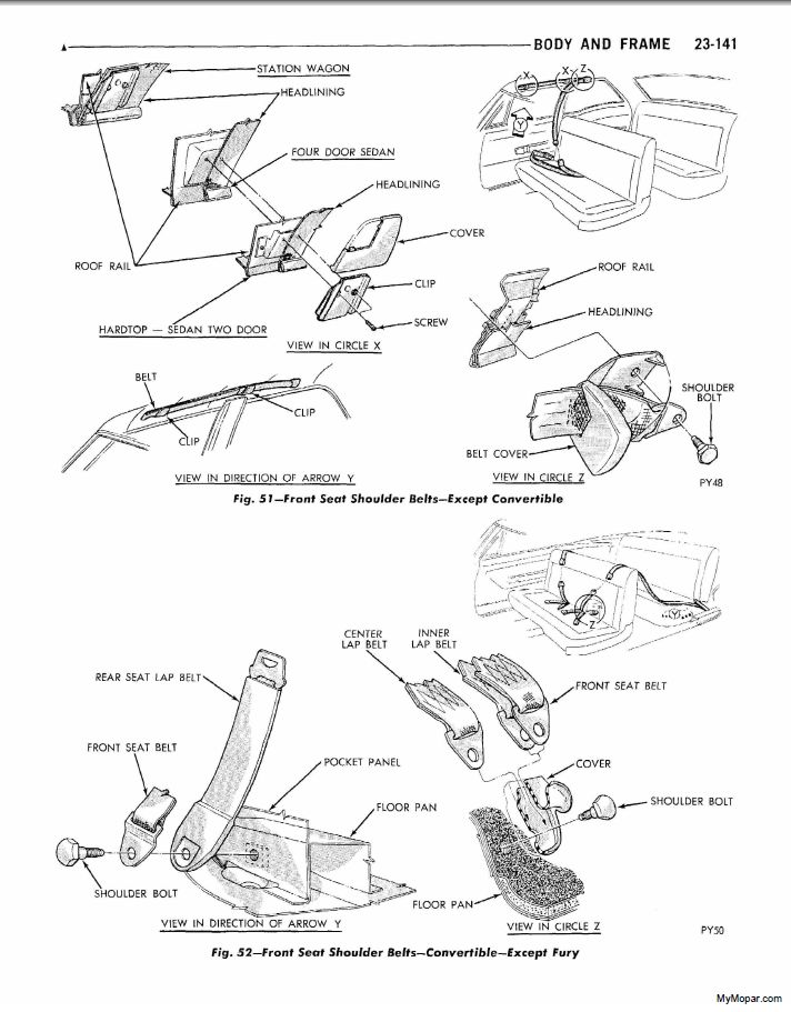

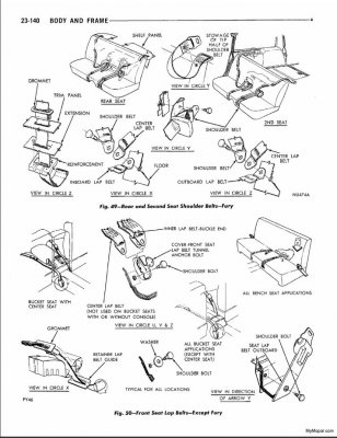

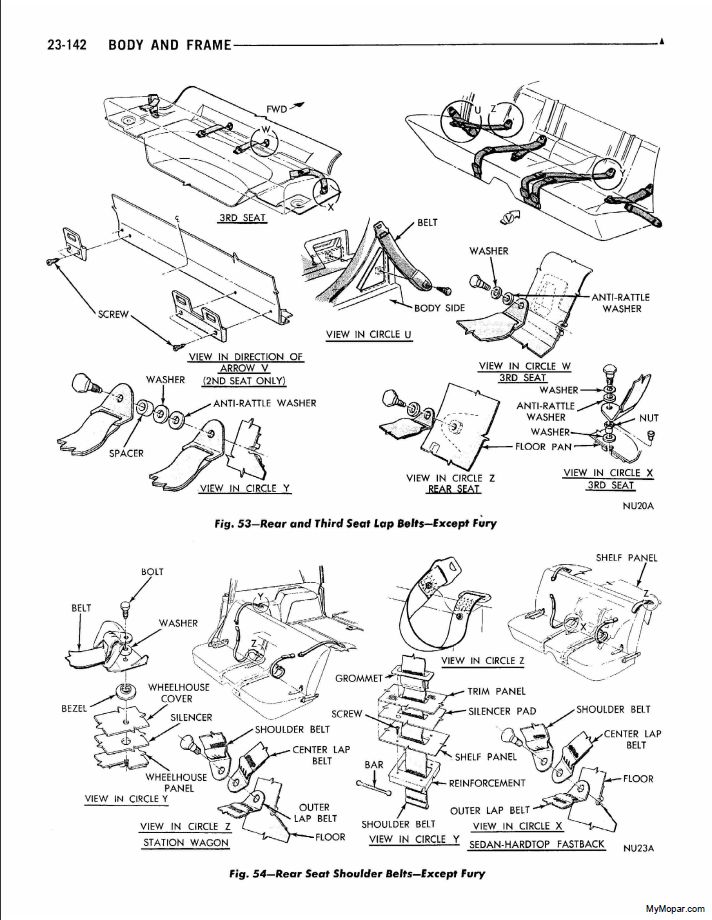

What are you putting them in? Here are some pages from the 1970 Plymouth service manual:
