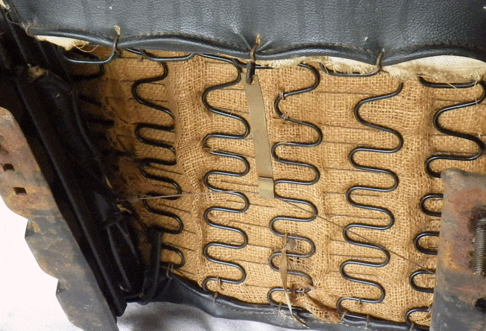

What the picture in post #2 is.
This appears to be similar to steel banding material.
If I were dimensioning it.........
It is .500" wide X .038" thick.
Straightened out would be 6.250" long.
The loop back is at 5.250" creating the 1.000" return.
The last .250" of the return has a detent that appears to trap the wire and creates a .125" curl outward likely to aid assembly.
The hole is approximately .250" diameter and .250" from the end (+.032" -0.0" for both)
