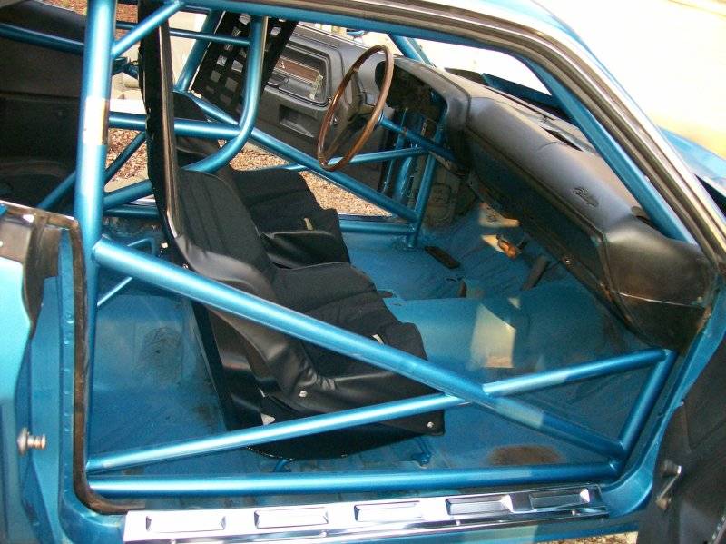

I use Kirkeys with their covers. Very comfy for an all out race seat. As for mounting, we fabbed tubular mounts and have a mount near the top of the back that goes to the roll bar belt cross bar. I will be moving to racecraft adjustable mounts for the bottom as I have to lift myself up to see over the hood currently.

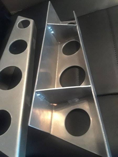

If you're looking for that '60s look and style, there are these low back buckets similar to the A100 van seats made by Smittybilt (44801 in black vinyl), which can be found on some of the 4x4 web pages. I bought these maybe close to 3 years ago for a project that I was involved in at the time. Of course you can make/have made some of the A990 type brackets and build them to fit your height and comfort level. BTW, I have this particular set still, if anyone might be interested.

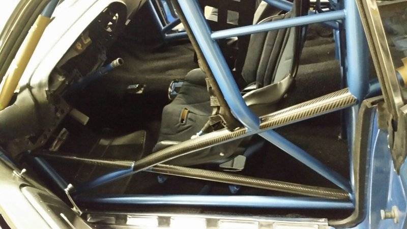

I have aluminum racing seats in one of my cars with padded seat cover. They are very comfortable. We made custom tubular framing underneath and bolts to custom made tubular tubular mounts to the cage with tabs. Don't have and good pictures of just the frames. They are more heavy duty than they look. They are gusseted and crossed braced underneath but can't be seen from side views.

Those look like my kirkeys
