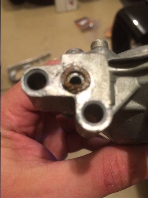

Here's one of the guilty gaskets
Now this all makes sense. I found a Six Pack article I stashed away with all my other Six Pack paperwork called "Installation and Tuning of the Six Pack Induction System" published in Jan 92 of Chrysler Power and it discusses the air bleed function on the secondaries very well. Now I understand Hemi what you were telling me to do.
