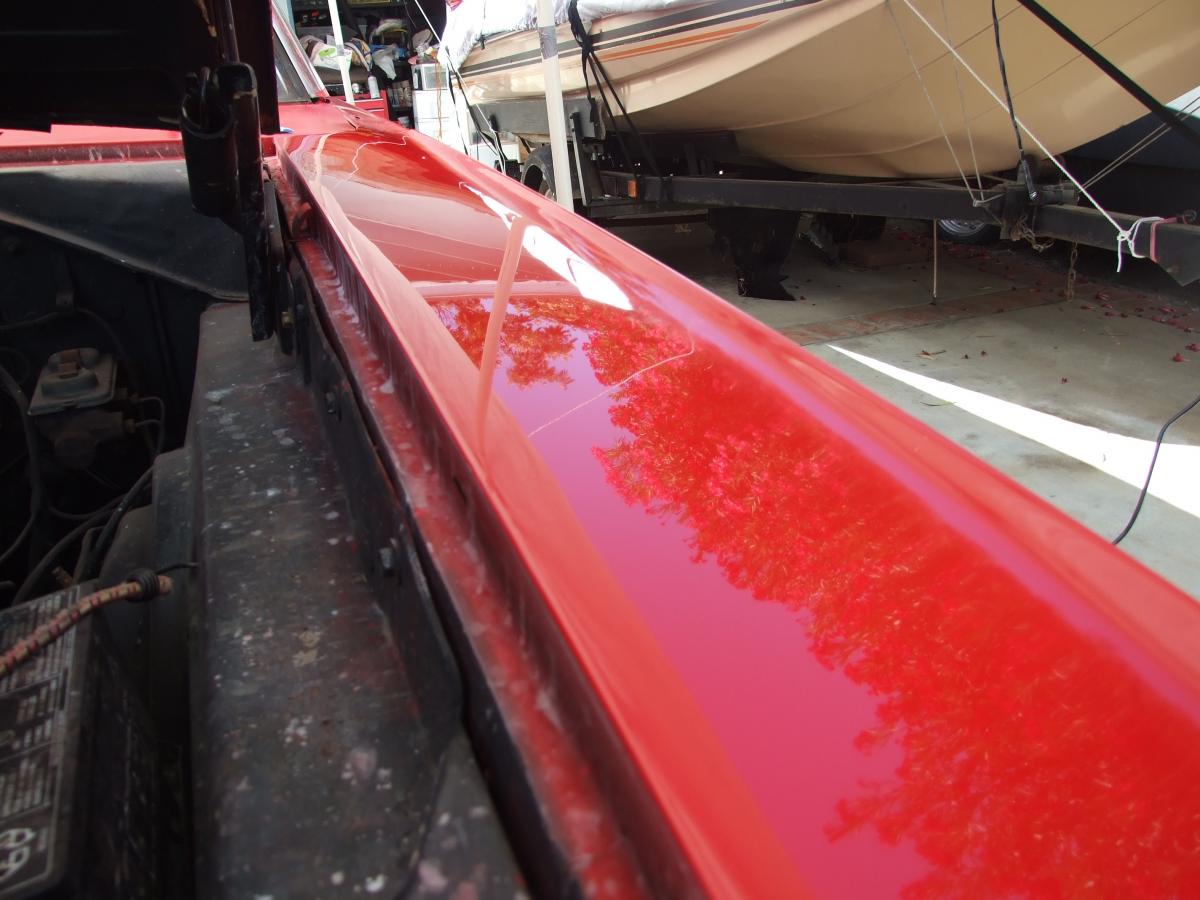

the idea of respraying more clear is not a bad idea only if you are willing to spray it on a little thicker, in my opinion a few small runs would be easier to sand out than all that orange peal. im not a profesional although my father and little brother are. i havent sprayed base coat clear coat in about ten years until this last weekend so i figured i would post a couple pics for you for reference purposes. this is only 2 coats of clear by the way and i have not touched it with anything since i sprayed it. spray the clear on so it looks like wet paint and give about 15 min between coats or you can touch a none visible area and if it leaves your finger print or the clear kinda pulls away stringy its ready for the next coat.

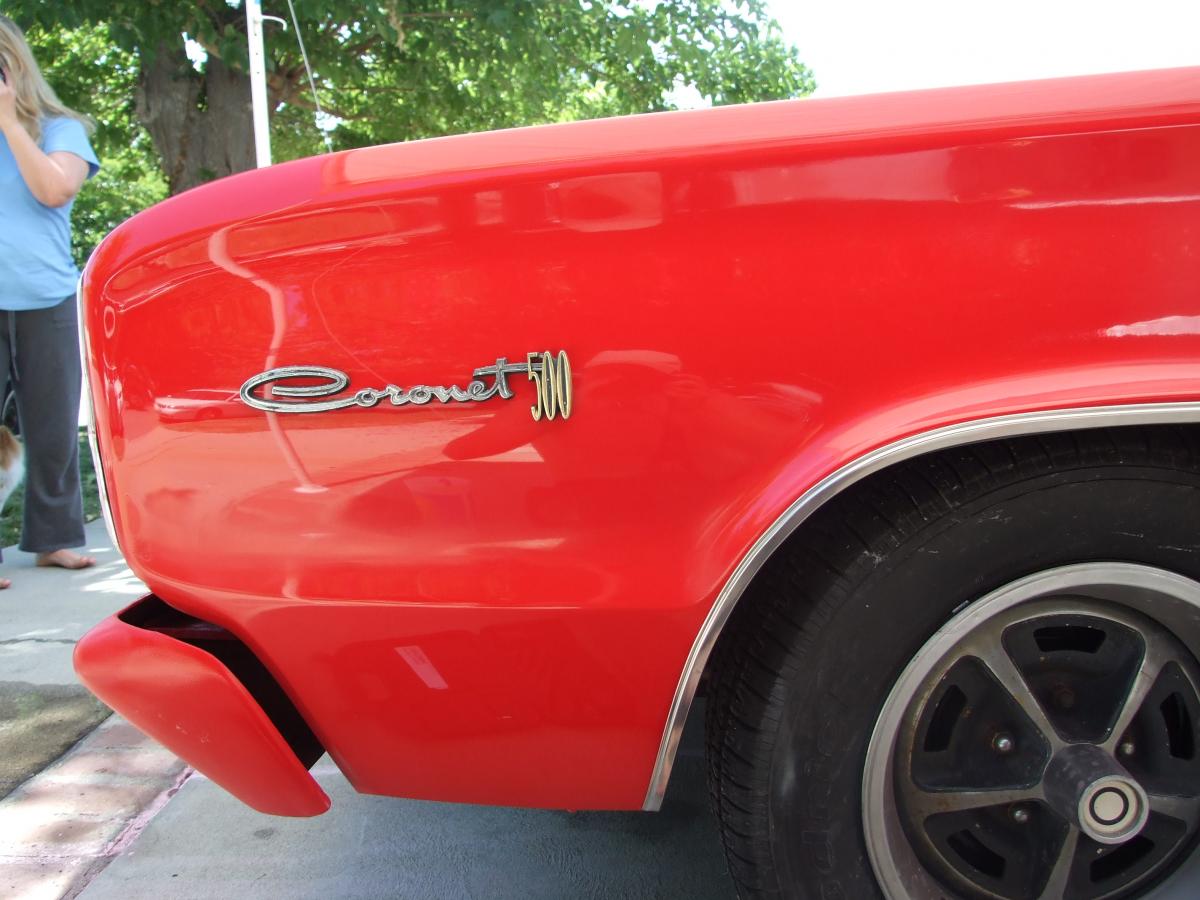

So, I believe I had made some progress with my wet sanding, and I have buffed and polished the top of the front left fender. I hope you guys enjoy the new photos, and it is now time time to tackle the rest of the car!

only 6 more months of wet sanding and buffing and you'll be good to go. lol just kidding its looking good so far
Lookin' sweet!!!!
