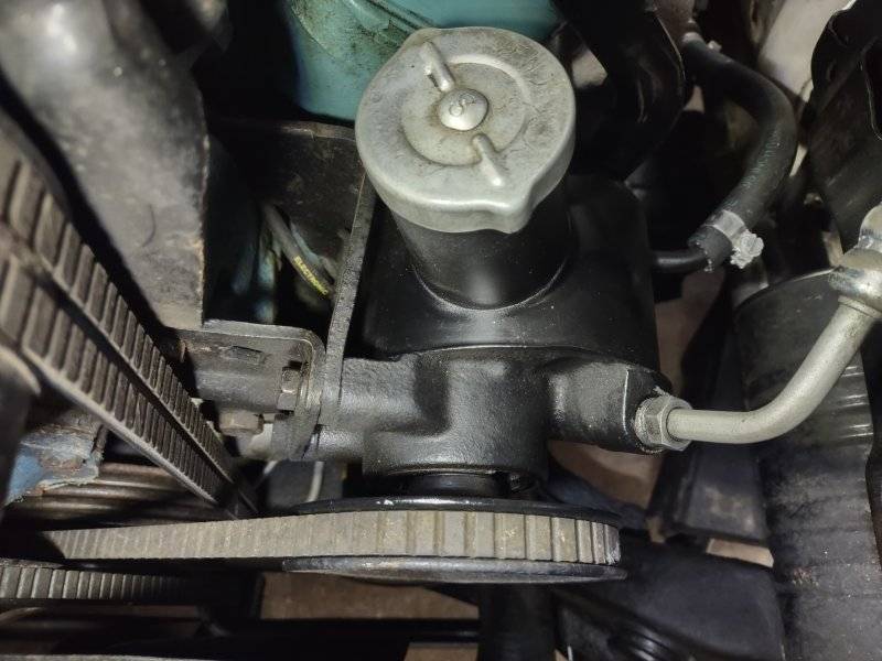

Shaft seal leaking on my 68 Charger 383 P/S pump, replacement or seal kit? (pic)

I have no clue which pump I have. Can anyone help ID this and point me in the right direction for either a replacement or rebuild kit? I'm also open to having it rebuilt professionally.

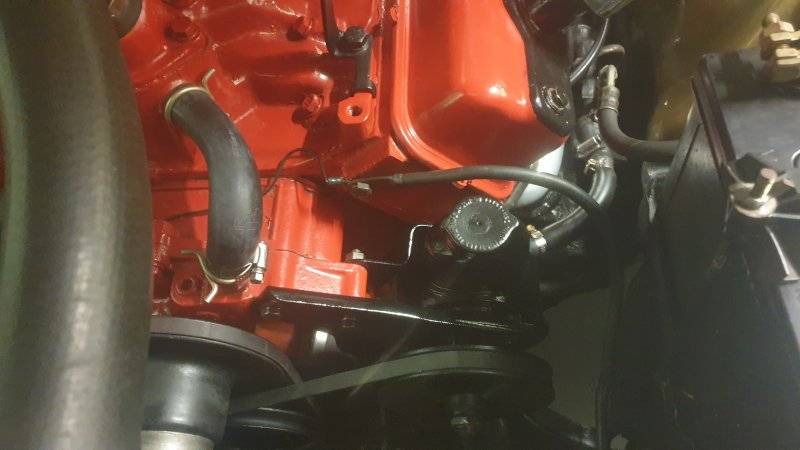

with new seals. You can do it yourself. Coincidentally I put my pump back in yesterday evening after pulling it to fix a leak from the shaft seal.

Nice, I have no idea which kit to buy, which was the intent of this thread. Did you need a special pulley in order to rebuild it?

You might, depending on pump. Mine is a '66 Saginaw and there is a nut that holds the pulley on. Later pumps might be press fit on a tapered shaft.

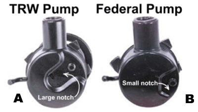

That is either a Federal or TRW. It is NOT a Saginaw.
I found this on another thread on this forum:
Based on your bracket, it's a TRW (Thompson). I've never rebuilt a TRW pump, but I think they're a little more involved than a Saginaw, which is just a vane style pump. Check out Youtube for rebuild videos.
I found this on Moparts, saying there are 2 sizes of TRW pumps: 4 5/8" & 5 1/8". "The “Small” TRW pump is the pump with the plain shaft, no hole, no hex. The Edelmann kit part number is 7897. The “Large” TRW pump with the hex shaft ( Does Not have internal threads to reinstall pulley) uses Edelmann kit number 7898. You can buy the kits from Rock Auto or Amazon".

Looking at the back of the pump, it looks like the Large Notch TRW pump on the left and the front shaft has no hole/hex.
It sounds like I need the Edelmann kit part number 7897 .
Thanks so much everyone! Now I need to figure out if I need a special puller or tools for he rebuild.
