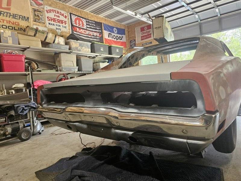

my buddy started the back end. Wall art on the floor.

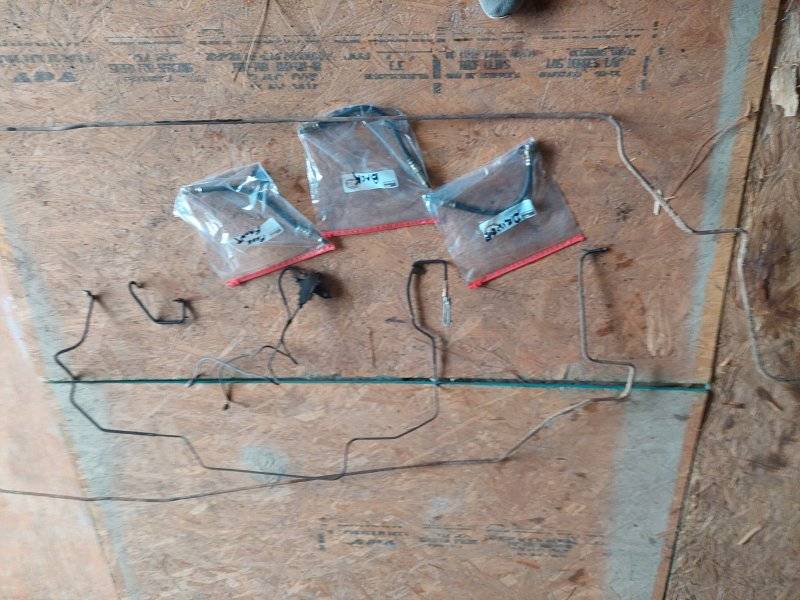

Getting the final stuff off the car. Brake lines and fuel line. The fuel line is long and learned pull the pass tire to get it out.

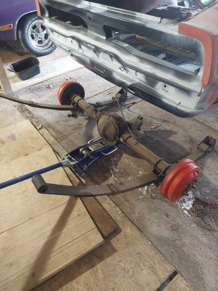

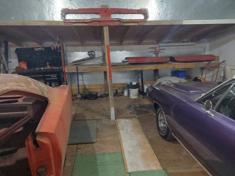

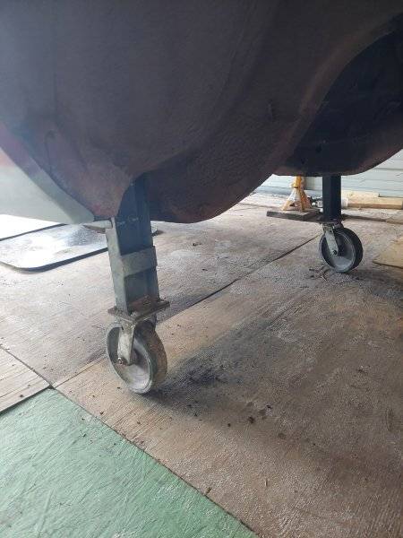

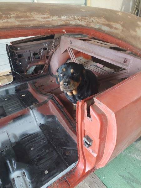

Today was pull the rear end out and install the frame dollies. I little tight in the carport but it works. Next is the k frame . Learned make sure the car /jacks are high enough for the dollies. :BangHead: I was 8 inches short. Thor hung out .
I keep thinking of a Daryl Hall & John Oates song title everytime I see this thread.
:lol:
Anyway, keep up the good progress.
:thumbsup:
You'll probably have some fun getting the new fuel line(s) in. I just did that a few weeks ago and it was not fun. Get the front of the lines fed through correctly at the front end. For the rear section, you'll need to bow the rear part of the lines quite a bit to get them routed properly up around the rear shocks and above the gas tank. I found that near impossible before I unbolted the rear-most tailpipe hanger on the passenger side tailpipe and pulled it down enough to help get that sucker in the right position.
