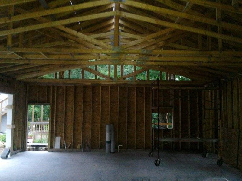

That's the plan for mine...Rather than having the ribs stick down mine would be facing up and the flat areas will be facing down.
I'm only using it on the scissor truss areas so I'll be able to do the install with no seams.
Planning on installing the 2x4 flat led light fixtures (7500 Lumen) under the steel.
R-38 above in the truss's.
It should make for a nice job when it's finished...

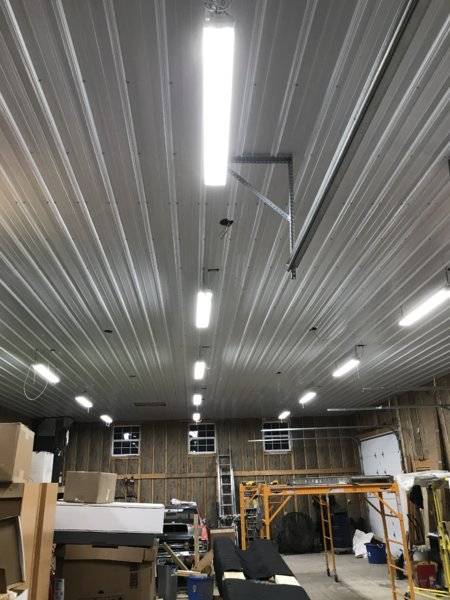

Ribbed steel for the ceiling, painted 7/16 osb for the sidewalls. Ceiling metal is thinner than exterior metal panels. Osb was cheaper than metal for the walls, easier to mount electrical boxes, cabinets, etc... Lighting is mounted in the flats on the ceiling. All metal walls and ceiling can echo really bad, it was recommended to use acoustic panels by Morton. This is a 48’x75’, 14’ sidewall building.

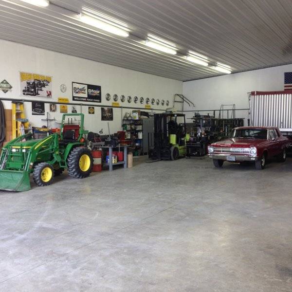

Well I had bent back and forth between drywall, OSB, or metal panels. Ended up choosing the metal panels. One, they would save thousands of pounds hanging from the structure. Second, once they were up they were up. I didn’t have to go back and mud, tape, sand, paint, etc. So far I’m pretty happy. I’ve mostly been working by myself, and working in a full garage adds to the difficulty. I went with menards pro-rib bright white. Can’t wait to get it done, what is up looks great.
Looks great. I have done both metal and suspended acoustical, metal is best.

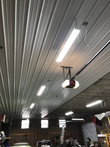

Mine are just galvinized roofing sheets. I have wiring both ways as door opener boxes and a light box was already wired before insulating (I have R52 in the ceiling) and then the florescents and future wiring to hoist etc have been run external in conduit and BX cable.
When wiring a garage always best to run everything in conduit on surface, three reasons, less chance of having an electrical fire and burning down your garage and your all your jewels inside, and also much easier to up grade and make changes anytime electrically. Last if you insulate, brings up your R value and keeps your garage warmer or cooler. I am an electrician by trade. Also Mr electrical inspector will pass your wiring every time.
