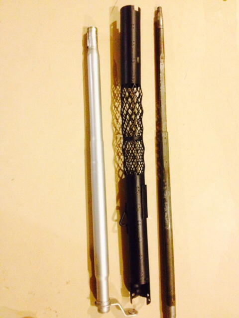

I believe this is the difference between the power and manual steering shafts, the on the bottom is for my power steering box. And they do slide but I am not sure you could slide the manual shaft in far enough? And if you did you would be at the limit where it could not collapse.
it will slide in far enough....have done this many times....

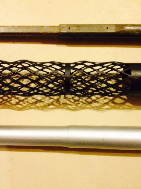

In regards to the collapsing section of columns the outer section that is under the dash crushes in like an accordian but where does the metal shaft in the center go if it's solid right to the steering box now that you have hammered it in?

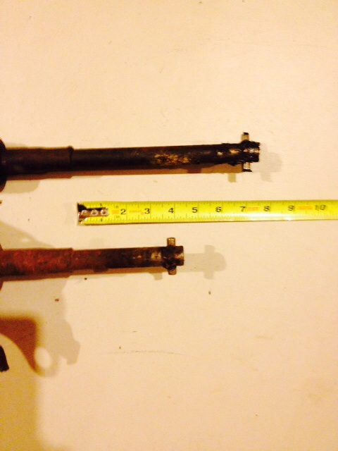

So as has been mentioned the extra length is the issue which needs to be either cut off from one end or the other so I can retain the plunge style mopar joint or if this isn't possible I would then need to replace the inner shaft with a shorter power steering one.
Is there anyone that has a measurement of the difference?
