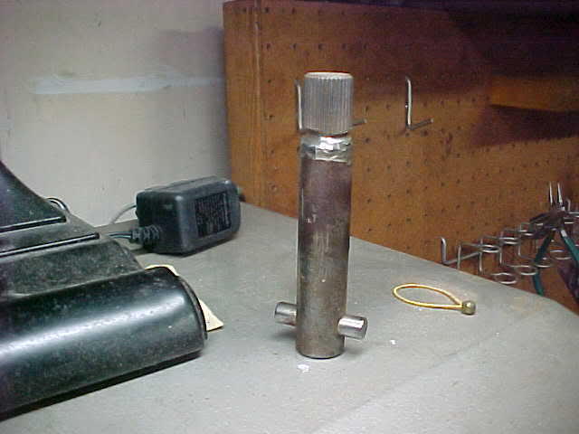

Here's a piece that I cut off at a junk yard just above the weld then ground the weld off and slipped out the end of the shaft. I didn't shorten it but did the same thing from another column and then slipped this piece into the column I wanted to modify. IIRC, this was from an E body.
