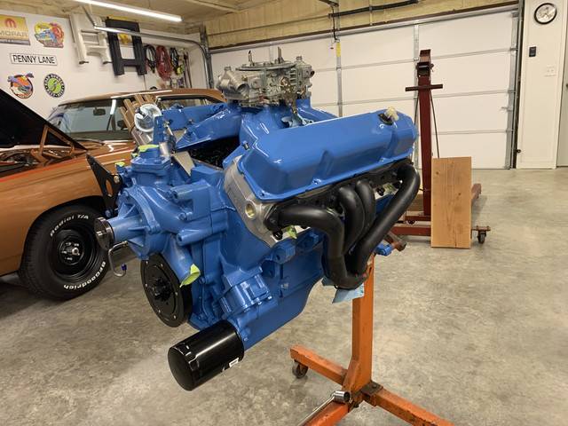

Here's a pic of my rebuilt Stealth head 440 with the Hedman shorties. Should be up and running soon!
Very nice - Looks great
Let us know how everything goes , up and running
I was wondering about shorties too. I don't think these will fit between the shock towers will they?
