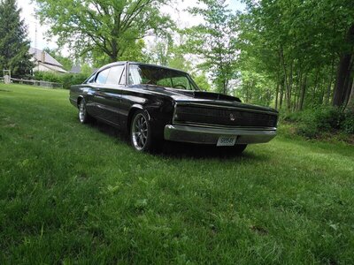

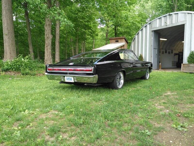

With a full interior? No fiberglass?
Yes, full interior. No glass. 4150lbs

All new rubber bushings, tie rods and joints.MP xhd torsion bars. I added 2 extra leafs to the rear springs. KYB shocks (the ones everyone says are too stiff) 2 inch lowering blocks on the rear. I aligned it at home with a string and a bubble level. Max caster, 1/2 degree neg. camber. 1/16" toe in. I resealed the power steering box, adjusted it nice and tight. Also rebuilt the steering coupler.Other than the massive tires, what,if anything did you do to the suspension? Mine will need new shocks at a minimum. It is more boat like right now.
