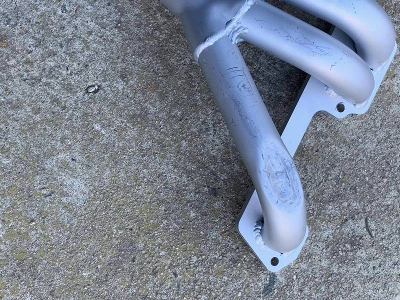

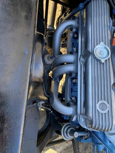

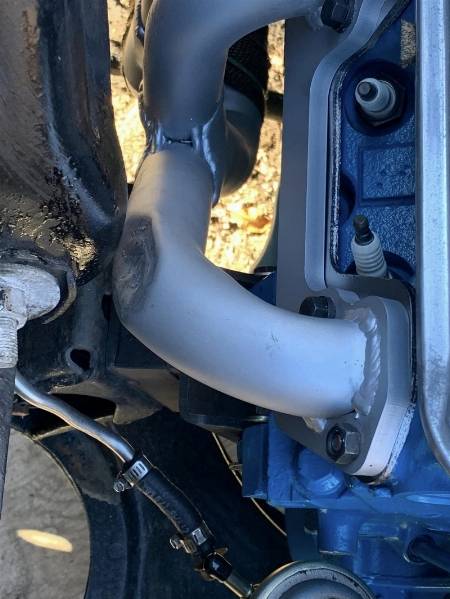

I figured I would show this for anyone doing the same swap. I put a 1979 360 into my 65 Belvedere wagon. I used the Transdapt motor mounts to alter the motor positioning. The bolts they came with are too long. I had to use shorter bolts on the bosses. I also had to grind a bit off the rubber mount.
The headers are Shummacher tri-ys. All I had to do was ding the #2 cylinder pipe on the passenger side for clearance around the shock tower. I also used the Mr. Gasket oil filter relo kit. The stock mount would have the filter right on top of the pipes. The drivers side, that I thought would be the problem area, just dropped right in. Very easy. I just wrapped the areas that were close to the starter and oil filter hoses in header wrap to help out with the heat.
