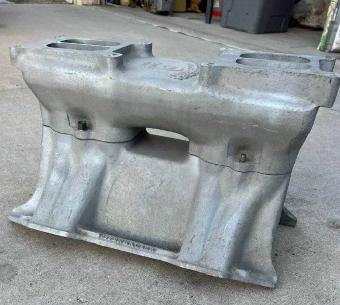

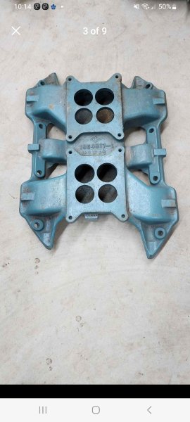

I've been looking at different intakes for my 413. I like things that are different and unique (hence why I have a '62 Dart) and have looked into a dual quad setup. I also like my power and have always said you can never have enough. The motor is currently mildly built with a Mopar Purple cam and a single Holley. What is everyone's experience with the dual setups? Are they worth the few extra bucks or is the single carb a better option? I've found an original factory 4x2 Mopar intake from '62 for cheap. I'm also eyeing the Edelbrock Performer RPM for a single carb setup. Just looking for opinions and thoughts.

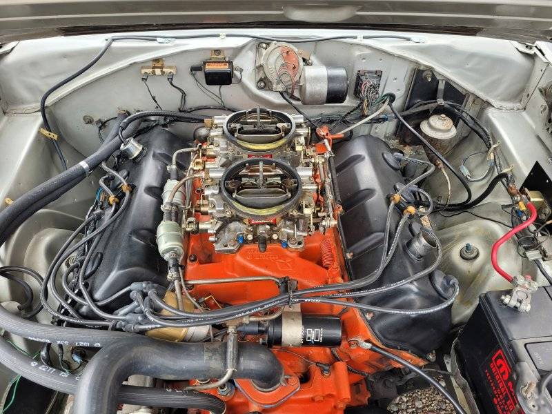

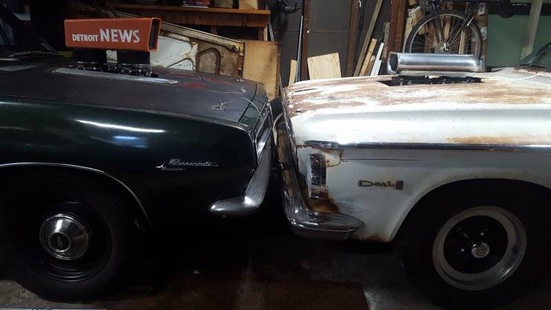

Mine's still sitting up here, I have enough trouble getting one to run correctly...

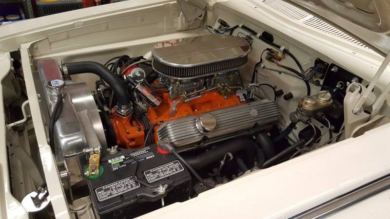

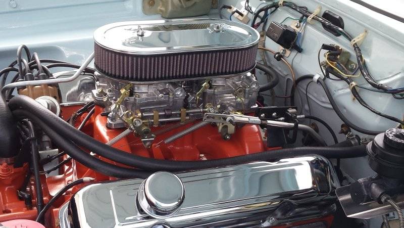

I have one of those if you look at the box to the right... just hoping I never have to touch these Eddy's or have to go back to the OE's ! (and that battery cable mess and brake master has been since corrected!)
I'm running that manifold and 600s. It does pretty good in my opinion. Most say a single will do better with the right manifold. These manifolds aren't what the new aftermarket ones have to offer. Apparently some of the 2x4 aftermarket aluminum ones didn't rate that good. (Talking inline fours)
It's mostly for the wow factor. I had a lean condition with the front four cylinders having the carbs hooked up progressive. Went with a one to one linkage and that solved that. (I still haven't figured out how the factory set them up)

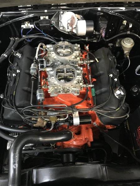

I don‘t Know if they run much better but they sure are cool looking. Once set up they aren’t really any greater trouble for a weekend cruiser. Bottom one isn’t mine but I wish it was.
