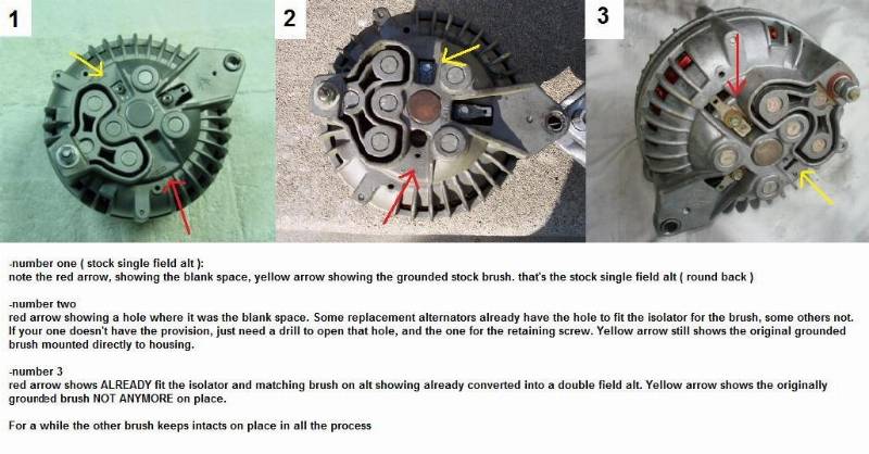

I have a 1968 single field, I need a dual field. Can I remove the grounded brush and put on a brush wiith a terminal for the 2nd field wire?
I know we can go the other way, but does the early single field alternator get changed over to a dual that easy?
Yes by adding the dual field insulator that holds the brush.
I bought the insulator awhile back but don't know where.
My guess may have been Rock Auto.
If the back looks like this, I think it's that easy.

depending on the single field alt you got. Some are ready to serve to both setups like the one posted above, mostly used for 70/71 &/or I guess also dealer replacement alts of those years to serve for both setups depending on the need of customer’s car at the moment the setup was changing from single to dual field, but those earlier models what don’t, can be converted drilling them up.
this is a writte up I made loooooong time ago with pics collected along the web. Some other ppl on several boards has used this pic and reposted too as reference.
then will need to get the brush kit or just the required brush and insulator if available by piece at the shop
you will need the ones on the left… insulation washer included To keep the brush insulated from retaining screw.
Maybe will require a small washer to shim a bit the insulator underneath, since is shaped to the small “towers” dual field insulator gets for the screw provision.
forgot to say, with this you will be getting both brushes insulated, which is the goal. Is not simply replace the non prong brush with a pronged one. On the dual prong setup the deal is get both sourced from wires and ungrounded from alt chassis instead one of them chassis grounded.
