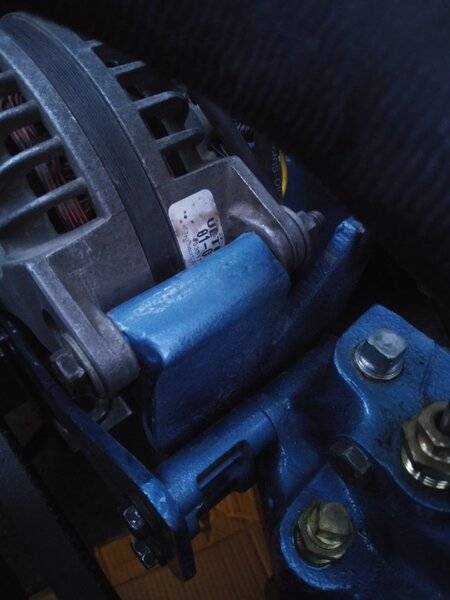

Well i assumed it was wiring because i pulled and tore down the motor, then rewired everything from the firewall on. By full field test im guessing you mean giving the field an unregulated 12v. Just tried that still wont charge could the alt have just stopped working from sitting a few months?
Is the other brush grounded to the case or do you need to ground it to body to complete the circuit
I was under the impression that a single field alt is grounded internally. Even ran a wire from the mounting stud to the ground cable because i painted the alt brackets that i made. Trying to wire a 60's alternator and i I feel like a monkey trying to work a computer.
It is grounded through the mounting screw only if the brush holder is not one to insulate brush
