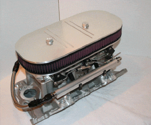

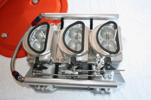

Here's a six pack efi system I was thinking of getting until I found out the cost of replacing the injectors.
http://www.fbthrottlebodies.com/
