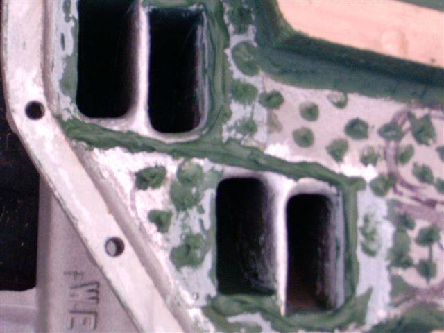

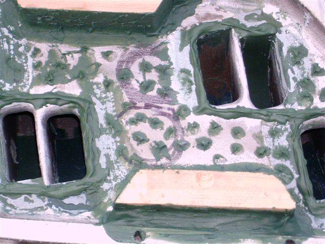

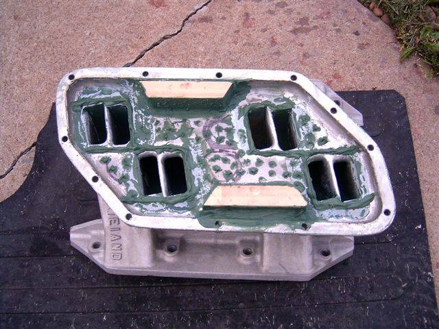

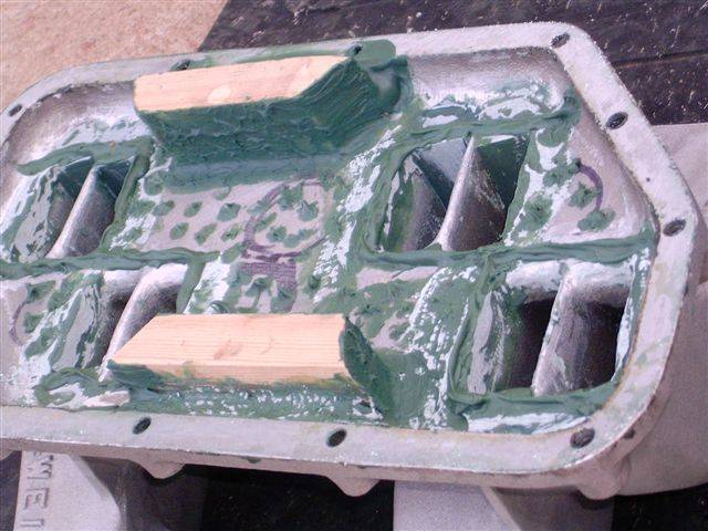

In my extensive, nay, psychopathic amount of research I did on the Weiand 6bbl intake and all of the satellite parts and tweaks, IF you have a stock or near stock displacement 440, I believe these mods are better than the ones in the Chrysler Performance manual, and this guy tried both ways.
His mods which obviously and per his own evaluation and observations reduced plenum volume, increased velocity and fuel atomization (or maintained it better) and effected flow patterns resulted in .20 faster ¼ mile times.
Here's some pix:
The green "epoxy putty" forms dams to prevent liquid fuel from running down the intake runners and the "dots" of it that actually resemble Hershey Kisses were an effort to reduce puddling, and he used some other material in the runners to change their shape and volume. Unfortunately, when I spoke and emailed with him, he had only run the 440 in his E-Body car with this arrangement for a year or 2 IIRC, so I'm sure further R&D can be done.

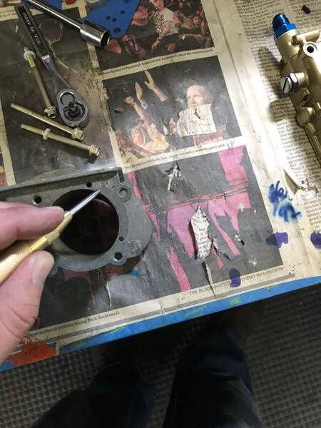

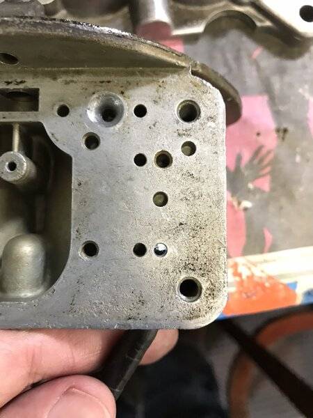

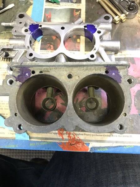

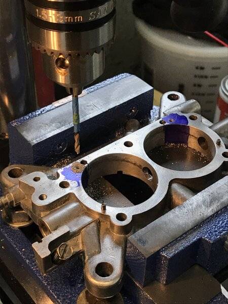

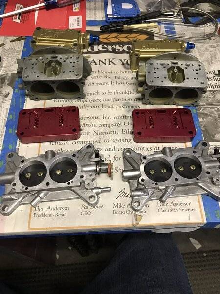

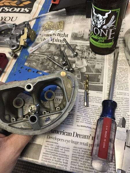

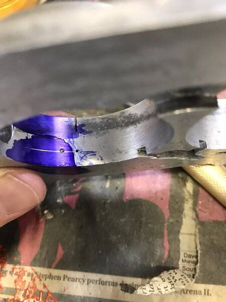

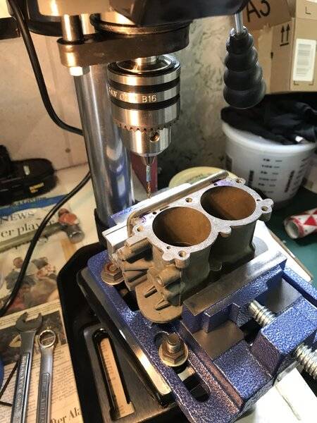

I also did a ton of work on my mechanical outboards. They have unadjustable idle circuits out of the box. I found them to be lean on my 511 so I added adjustable idle circuits and adjustable IAB’s as well. I run a 4412 as a center instead of the tiny stock carb.
View attachment 1141176 View attachment 1141177 View attachment 1141178 View attachment 1141179 View attachment 1141180 View attachment 1141181 View attachment 1141182 View attachment 1141183 View attachment 1141185 View attachment 1141184
Nice work! You must be a machinist or maintenance in a factory
The 02 meter is a innovative LM2 https://innovatemotorsports.com/products/lm2.php.
I couldn’t do 3/4 of the stuff I do without it. It really opened the door for me to really dig in and lean how to manipulate all the circuits on these carbs. In other words it’s some of the best money I could have ever spent. Lol. I only run it on the car when I’m tuning. I’ve used it on a few other cars as well when doing carb work. Some guys put more permanent gauges on, I just don’t see the need for it. Once they’re tuned up they don’t change. I did do a thread on the mechanical carbs a few years back. I’d have to look for it.
Here's some pix:
View attachment 1141304 View attachment 1141305 View attachment 1141306 View attachment 1141307

A curiosity question regarding the epoxy "additions" to the STR manifold.....are you concerned with any of the epoxy pieces or the wood volume reducing pieces coming loose during operation and being injested?? I would think that the cured epoxy pieces are solid rather something like cured RTV. Being solid, would they shatter if caught in a valve or smashed by the pistons? Just asking......

I dont want to speak for anyone else, or put words in anothers mouth, but.... i think 68 hemi was referring to the carb mods, which look terrible, rather than the manifold, which doesnt look terrible but admittedly needs work to work well.
Intake mods have worked and the one with all the epoxy, that guy has probably pissed with that intake more than anyone and I know he nailed the performance of pretty good because I tried to purchase some of his stuff and he said it's going to
