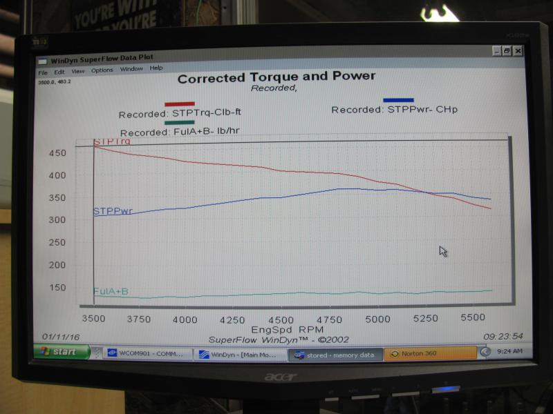

When I had my engine dyno'd it made 590 hp, then he made a pull just on the center carb 390 hp
But that was with stock center carb.

i'm surprised you could get 390hp. what was the manifold vacuum at 390hp? those center carbs are only 250cfm @ 1.5"hg.

I couldn't tell you that lew, wasn't there for that pull.

That run was just for grins and giggles and I've thrown the dyno sheet away, so there is no record left of the vacuum. I'd have to put a new room in the shop if I kept every dyno sheet.
The center carburetor is (and was on that dyno run) 350 cfm, and the outboards are 500 cfm, so 1350 cfm total. So then, this equates to about, what, a 960 cfm 4-bbl? I knew exactly once.

the 1350cfm rating is at 3"hg. original rating on the carbs was 250 center, 390 ends at 1.5"hg. but 1030 doesn't market as good as 1350.
